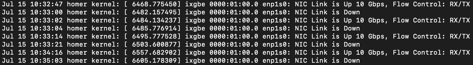

I’ve been trying to get a 10 Gbits link up and running for some time now, unfortunately the connection is flapping with an intervals of some secounds.

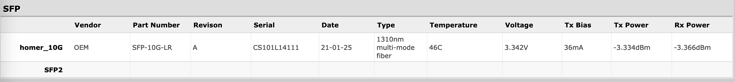

The RX power level on the SFP+ module is fine (between -5 and -3 dBm).

Both connected and 10 Gbit/s (with and without flow control): flapping
