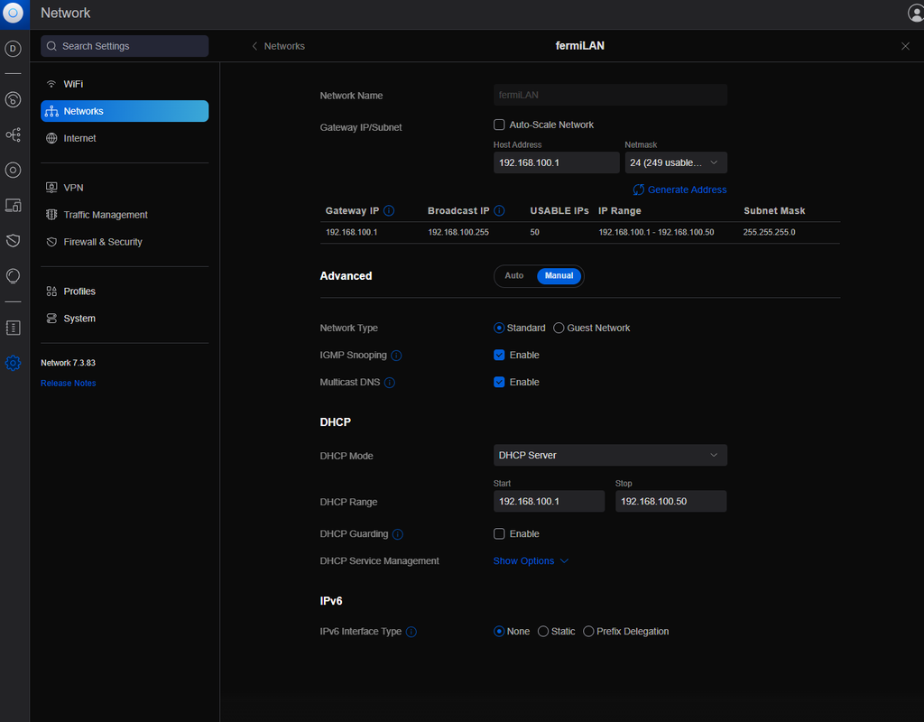

At my home, main router is Mikrotik CRS326-24G-2S+. On interface eth24 I have Ubiquiti UAP-AC-HD access point connected with cable and everything works fine. IP address of router is 192.168.100.1. On access point, I have added WiFi network named fermi and it works fine. Its network settings are shown here:
All clients are connected to this wifi (in the range 192.168.100.1-192.168.100.50, and they work fine. However, I would like to introduce guest wifi network on its own subnet (in the range 192.168.101.1-192.168.100.50) so the clients, connected to guest network, do not “see” clients on primary network (i.e. fermi). Therefore I’ve added second WiFi network to access point:
Now, the problem is an arbitrary device “sees” network fermiGuests, but it does not receive network address (IP number) from DHCP server from Mikrotik. How do I spawn two DHCP servers in Mikrotik on interface eth24?
It’s easy IF the access point is VLAN aware. However I don’t see any indication on the AP config pages of VLANs. IF the AP is VLAN capable, configure it for two different VLANs - one for each SSID. Configure a separate DHCP server for the guest WiFi SSID.
Correction. I missed it on the Guest SSID that it DOES allow specifying a VLAN (I was primarily looking at the primary SSID setup page).
Don’t expect too much performance using CRS326-24G-2S+ as router doing Nat etc because it has a little cpu
If you are using a Mikrotik, or any other non-Ubiquiti gateway, the UniFi controller network settings have absolutely no effect. You can’t remove the inbuilt base/untagged LAN network and replace it with a VLAN-only network, but there is little point in using anything other than VLAN-only networks for additional VLANs. These are used by the UniFi controller solely to associate UniFi AP SSIDs and UniFi switch port profiles with particular VLAN IDs.
The Mikrotik will need a hybrid trunk port with a matching VLAN to the one chosen for the guest network, IP gateway address & DHCP server adding to provide the guest network, and firewall rules to limit access.
UniFi APs do have features not present on many other manufacturers - you can indicate an SSID is for guest devices which will prevent access to other devices on the same subnet, i.e. you can use the same subnet for main and guest devices but the guest devices are isolated avoiding the need for a separate subnet.

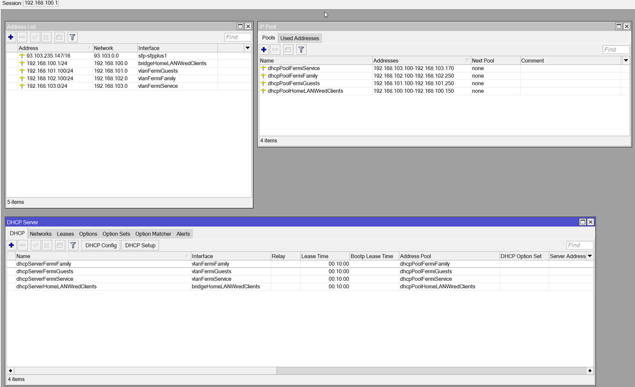

1st Problem) Now, on Mikrotik side, I’ve put “fermiServiceVLAN” ip range into IP->Address table and if I enable it, WAN stops working across apratment on all wired devices, Why?
2nd Problem) WiFi devices can connect to all three WiFi networks, but they cannor reach WAN. How do I fix that?

Here is my Mikrotik’s configuration, like you asked for:
# mar/05/2023 18:35:58 by RouterOS 7.8
# software id = A957-GW74
# model = CRS326-24G-2S+
# serial number = **********
add admin-mac=B8:69:F4:8F:36:4E auto-mac=no comment="home lan wired clients bridge" name=bridgeHomeLANWiredClients

192.168.100.1/24 and 192.168.100.160/24 are the same subnet, you cannot use the same subnet on different networks.

You can’t assign several ranges from one subnet to different layer 2 interfaces, it has to be the same network. Get rid of vlanFermiService (and the unused vlanHomeLANWiredClients), move/merge services to the base bridgeHomeLANWiredClients interface (maybe give it a better name), configure the WiFi SSID to use no VLAN ID (untagged).
Ok, I have moved vlanFermiService to its own subnet, here is current situation:
Now, how do I force WiFi enitties to gain access to WAN? I get local IP, if I connect to any of these WiFis, but I cannot get to WAN?
The /ip dhcp-server network settings are incorrect, the gateway has to be within the subnet assigned unless you have manually configured static routes on each client.
That’s it! Thank you very much, I’ve set them up like an hour ago .. now everything (for this phase :smiley:) is ok!
