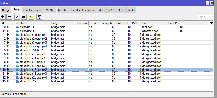

The port role in Bridge (RSTP) takes time to be set (don’t know it it could be the cause or an effect of the CPU spike).

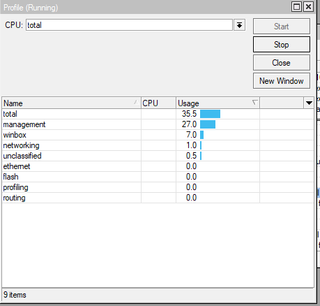

When all is fine:

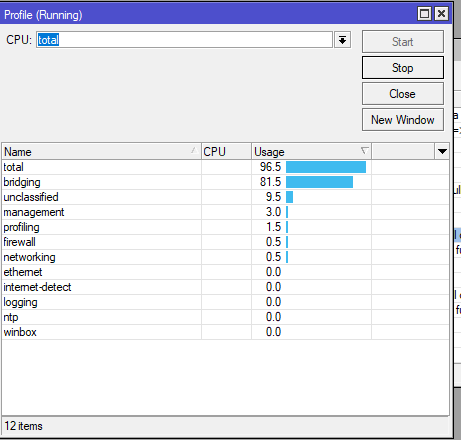

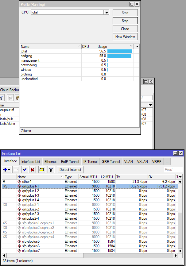

If you take down a port in winbox, cpu spikes for a while (could be 20-30s easily) and the switch freezes basically on this moment
You do it on one switch, but creates a similar reaction in the other switch connected with some seconds of delay.
So maybe is RSTP related

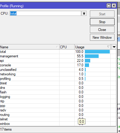

Doing an export of the conf is painfully slow and the CPU spikes to 100%. In profile is “management” the one using the CPU basically.
When i say slow is that an export could take 4 min easily.

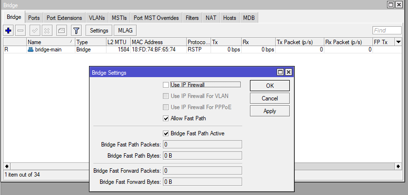

Tried to check if removing the FAST FORWARD on the bridge and adding Ingress filtering could help, but they have the the same issue.

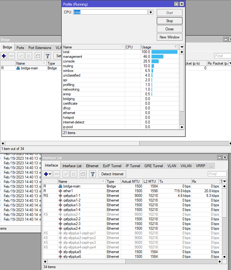

The switch becomes unresponsible with those peacks, not only in the management/Winbox/shell, it start loosing packets or not switching at all during a little while.
When the peak happens, i’ve seen that the bridge can even disappear.
Here a put in shutdown several ports, the peak comes and i see brige leaving the interfaces:
And when it relaxed, it came back:

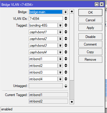

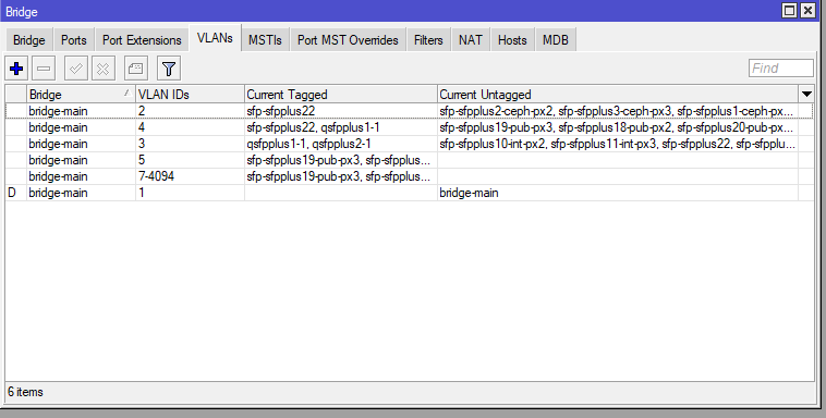

Then when we add the last rule to allow to use some ports as TRUNK ports, so can use (almost) any VLAN in tagged (802.1q) mode, in that case VLAN 7 up to 4094:
the CPU problem described in the post, with “bridging” using all the CPU comes inplace.
It i remove that VLAN rule (vlan 7-4094 as tagged in some interfaces) from the Bridge, then after it’s removed all comes back to normal
If i add the same rule with just a few vlans, with 100-300 for example (200 VLAN), there’s no problem.
What could be the problem for that to trigger that big issue?

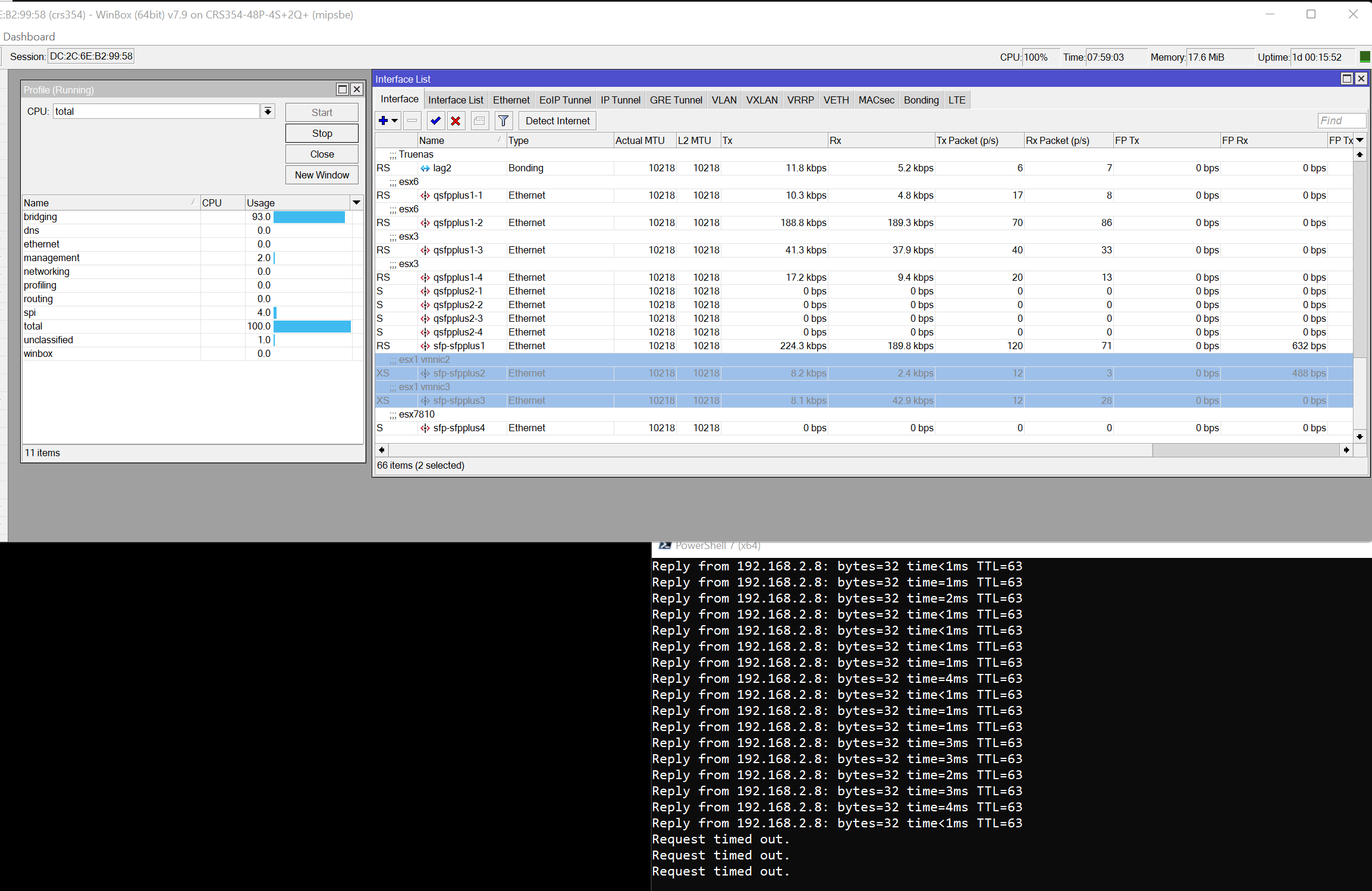

Im having the exact issue on a crs354 (and crs310) - all connectivity goes down + 100% cpu when a server (trunk) port comes online and goes offline.
ROS 7.9
