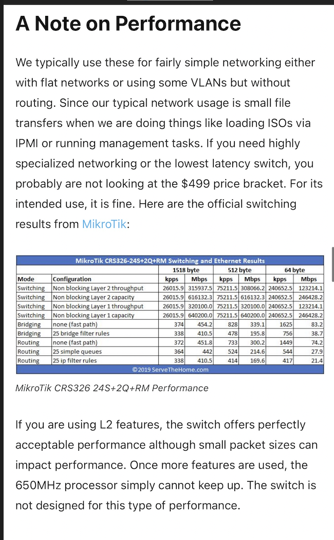

CRS326-24S+2Q+Rm -- Did I buy the wrong switch
So I do a lot of concerts and we run a ton of fiber. so Ive been buying the crs328-4c-20s-4s+rm and it has been amazing. Just enough 10 gig to go to my routers and ive been really happy with performance. But we just order like 10 Cisco switches that are going to be coming with 10 gig SFP+ ports so I was like wow im going to need something that can handle all these fiber endpoints and still do it from one switch.. SOOOOO I got myself 2!! lol.. CRS326-24S+2Q+Rm.. And I felt because of the hard ware offloading with vlan filtering that im going to be set! and then I read this review. (Ill leave the snapshot on the post) and it mentioned this..
“If you need highly
specialized networking or the lowest latency switch, you
probably are not looking at the $499 price bracket. For its
intended use, it is fine. Here are the official switching
results from MikroTik:”
and
If you are using L2 features, the switch offers perfectly
acceptable performance although small packet sizes can
impact performance.
I dont plan on doing anything but layer two.. just trunking VLANS to switches. I hope I dont have anything to worry about. Ill even post one of my configs I use on the crs328-4c-20s-4s+rm to make sure I dont have something on that I should.
Thank you so much..
