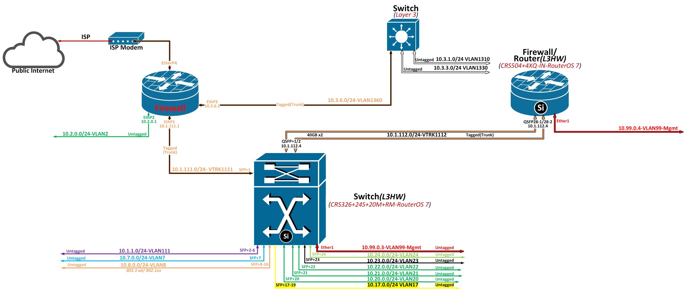

Finally was able to finish this simple config. To get a simple access port/trunk configuration working. Now I need some help with locking down the VLAN filtering. Any links on a good way to make sure it is locked down?

Also getting a CRS504-4XQ-IN to drop in and do stateful firewall/routing offloaded to HW as well.
Question is should i do a one-leg model for just those VLANs that I am wanting to route/firewall or should i put it inline prior to my Firewalla firewall which with this current config is the next hop and is serving up DHCP & DNS.
Options:
  1. one-leg ---- Internet->Firewalla->CRS326-24G-2S+RM(L3HW VLANs)
    |(2x40GB -QFSP+)
    CRS504-4XQ-IN(Routing/Firewall-HW-Offload)
  2. inline - Internet->Firewalla->CRS504-4XQ-IN(Routing/Firewall-HW-Offload)->(2x40gb-QSFP)->CRS326-24G-2S+RM(L3HW VLANs)
Here is the high-level Network Diagram of what I am trying to do.
  1. Firewalla Gold + [4x2.5gb]
  2. Primary Function: Internet Firewall
  3. L3 Switch(Work VLANs)
  4. Mobile Devices
  5. Uplink to internet
  6. CRS326-24S+2Q+RM+ [2xQSFP+40gb & 1xSFP+10gb]
  7. Primary Function: L3 HW Offloading
  8. Video streaming - VLAN7(Video Streaming Server), VLAN8(TVs)
  9. VLAN24 - Music Streaming from Internet
  10. CRS504-4XQ-IN [2xQSFP28-100gb]
  11. Primary Function: Firewall-HW Offloading
  12. Segmenting IOT/Security Devices VLAN20-23 (10G)
  13. Firewall “Stateful Inspection” for Video/Music Streaming/TV
Any advice would be helpful.
