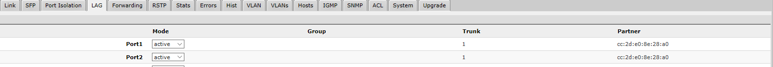

My setup:
CRS328:
sys pack print where name~"router"
Flags: X - disabled
 #   NAME                                     VERSION                                     SCHEDULED
 0   routeros-arm                             6.43
int bond pr
 0  R ;;; Trunk port for bonding to CSS326
      name="Trk1" mtu=1500 mac-address=CC:2D:E0:8E:28:A0 arp=enabled arp-timeout=auto slaves=ether1,ether2
      mode=802.3ad primary=none link-monitoring=mii arp-interval=100ms arp-ip-targets="" mii-interval=100ms
      down-delay=0ms up-delay=0ms lacp-rate=30secs transmit-hash-policy=layer-2-and-3 min-links=0
 1  R ;;; Trunk port for bonding to Cisco 2950
      name="Trk2" mtu=1500 mac-address=CC:2D:E0:8E:28:A2 arp=enabled arp-timeout=auto slaves=ether3,ether4
int br po pr where interface~"Trk"
Flags: X - disabled, I - inactive, D - dynamic, H - hw-offload
 #     INTERFACE                 BRIDGE                HW  PVID PRIORITY  PATH-COST INTERNAL-PATH-COST    HORIZON
 0   H Trk1                      bridge                yes    1     0x80         10                 10       none
 1   H Trk2                      bridge                yes    1     0x80         10                 10       none

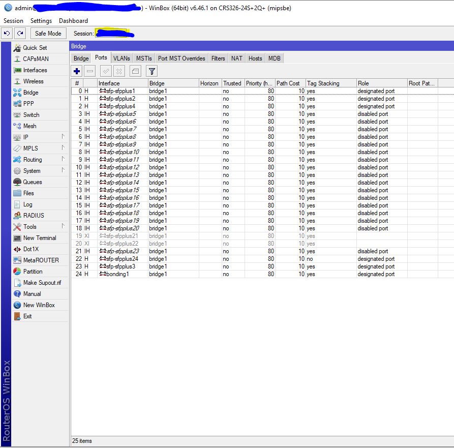

CSS326
6.46.1 works good with vlan
