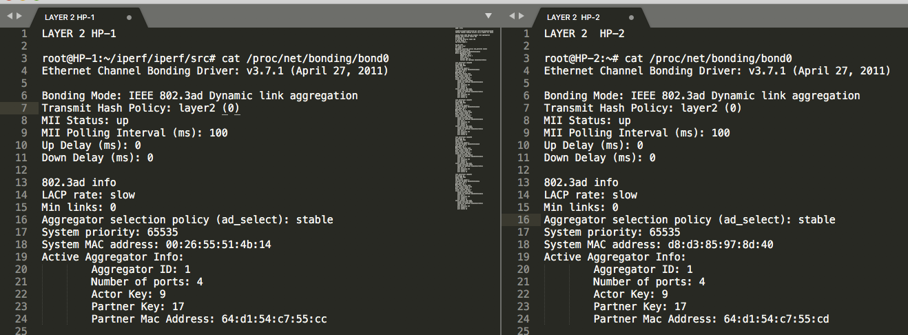

TRANSMIT-HASH POLICY L2
HP-2 Server – HP-1 Client.
BONDs:
Linux Bond Config:

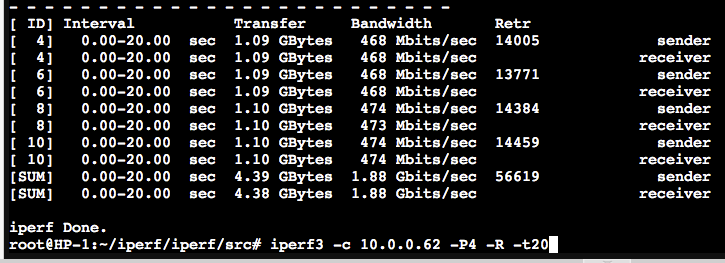

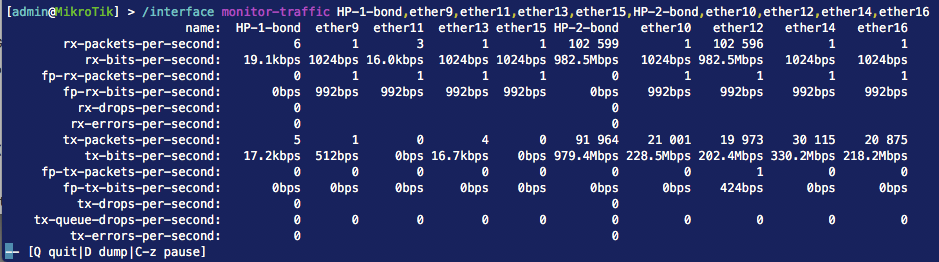

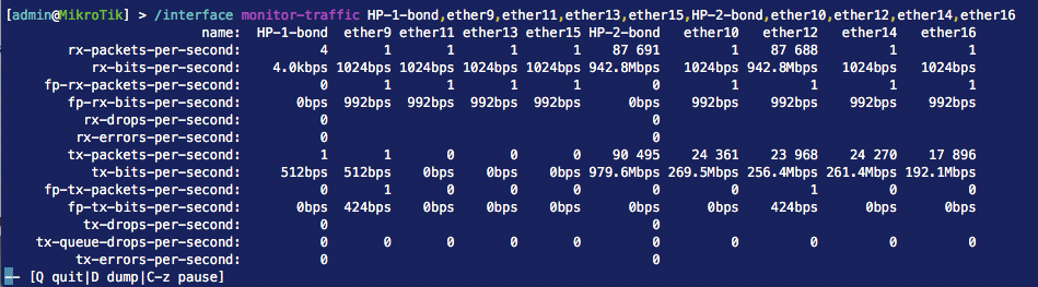

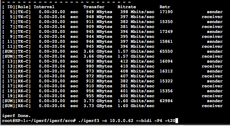

iPerf with 4 threads

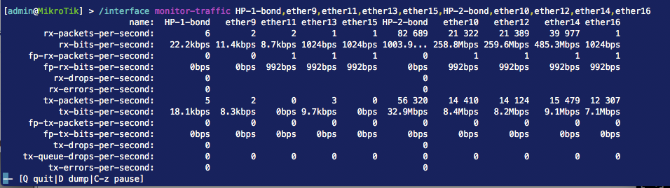

Monitor interfaces:
From this setup: We are talking L2 Hash policy (MAC), So from 1 IP to another IP (L3). Both received on 1 Interface but send only from 2 interfaces.
(I thought this only would use 1 NIC (1 MAC source 1 MAC dest).

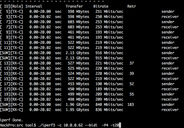

So the next test :

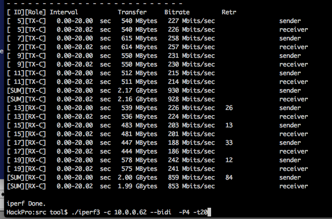

Iperf from a PC with 1 NIC 4 threads and bidirectional
In this case all four HP-2 nics send traffic to 1 NIC and the server receives on 1 NIC.

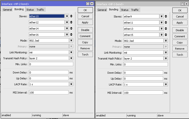

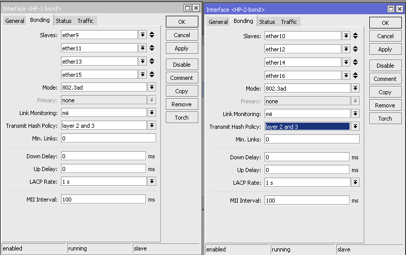

CRS326 config:
PROXMOX servers:
Iperf bidirectional with 4 threads
Same behaviour as L2, only one receive and two send.

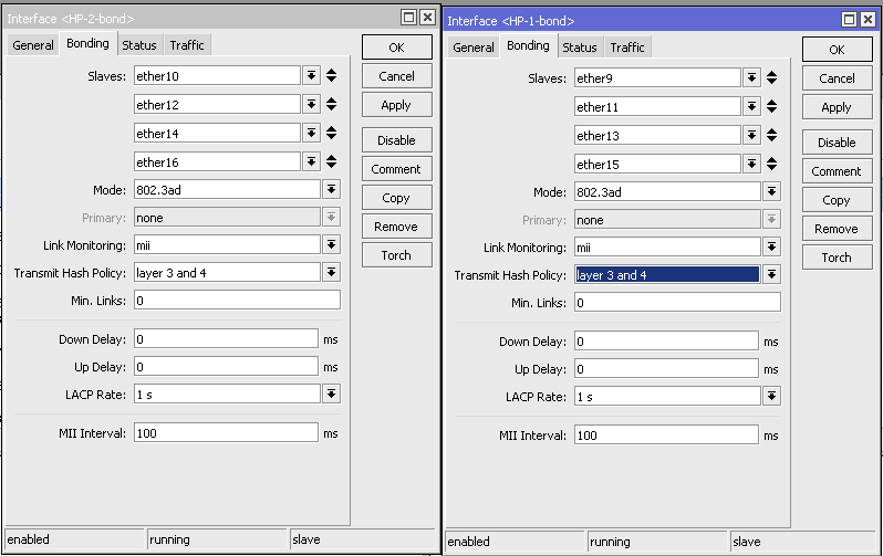

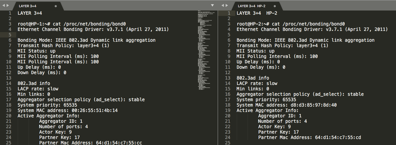

TRANSMIT-HASH POLICY L3+L4
This method wasn’t avaliable on my previous switch, and this is not supported on 802.3ad standard.
[admin@MikroTik] > /interface bonding print
 0  R ;;; LACP-9,11,13,15
      name="HP-1-bond" mtu=1500 mac-address=64:D1:54:C7:55:CC arp=enabled arp-timeout=auto slaves=ether9,ether11,ether13,ether15 mode=802.3ad primary=none
      link-monitoring=mii arp-interval=100ms arp-ip-targets="" mii-interval=100ms down-delay=0ms up-delay=0ms lacp-rate=1sec transmit-hash-policy=layer-3-and-4
      min-links=0
 1  R ;;; LACP-10,12,14,16
      name="HP-2-bond" mtu=1500 mac-address=64:D1:54:C7:55:CD arp=enabled arp-timeout=auto slaves=ether10,ether12,ether14,ether16 mode=802.3ad primary=none
      min-links=0

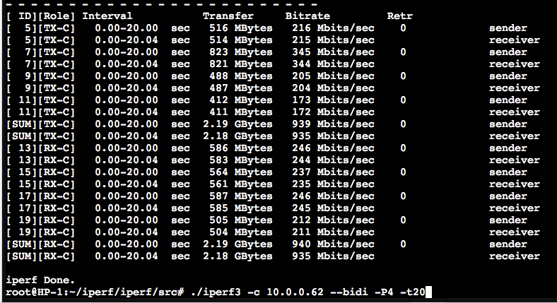

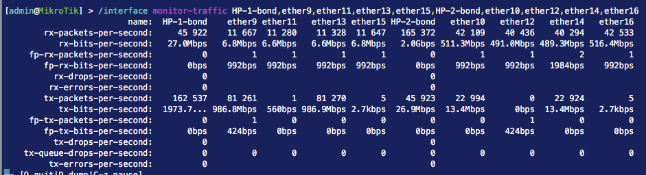

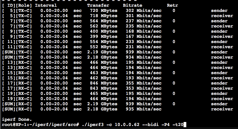

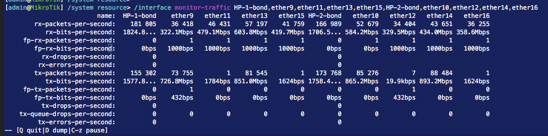

Now with iperf bidirectional full duplex (both servers HP-1 and HP-2) send and received traffic with 4 threads.
Now we have both servers received on 4 NICs! but only sending with 2 interfaces (Same behaviour on L2, L2+L3, L4) The receiving part is strange.

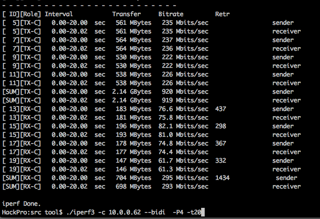

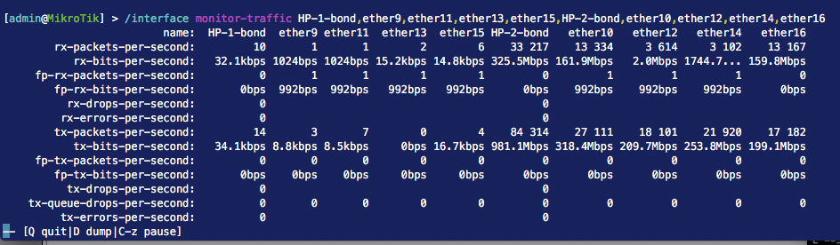

Testing with 1 client, iperf bidirectional 4 threads.

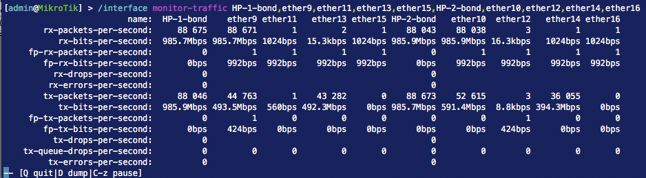

This test results in very low performance on the receiving side (HP-2) so I did another test just sending traffic to the server.
This yields full gigabit performance but receiving on 4 nics (HP-2).
Another test:
The HP-1 send traffic iperf -R to the HP-2 server with 4 threads and uses 2 NIC to send and HP-2 receives with 2 nic.
2 gigabit.

CRS3xx series switches are using L2+L3+L4 as transmit hash policy globally, regardless what you select on the CRS3xx side.
https://wiki.mikrotik.com/wiki/Manual:CRS3xx_series_switches#Bonding
Note: The built-in switch chip will always use Layer2+Layer3+Layer4 for transmit hash policy, changing the transmit hash policy manually will have no effect.
It is called the “transmit” hash policy, it makes a difference when sending or receiving traffic since the hash will be generated on the sender’s side. Also, it is very important how you test the bonding interfaces, you can’t expect that LACP will load balance single destination traffic:
https://wiki.mikrotik.com/wiki/Manual:Layer2_misconfiguration#LAG_interfaces_and_load_balancing
So the hash policty settings on the CRS-326 don’t affect. (I’ll test that later)

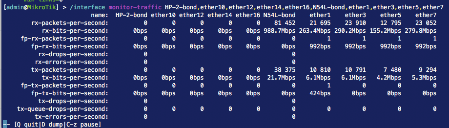

Fox example this is a test from another LACP server, with OpenvSwitch with 4 NICs 802.3ad “TCP balance” (L3+L4)

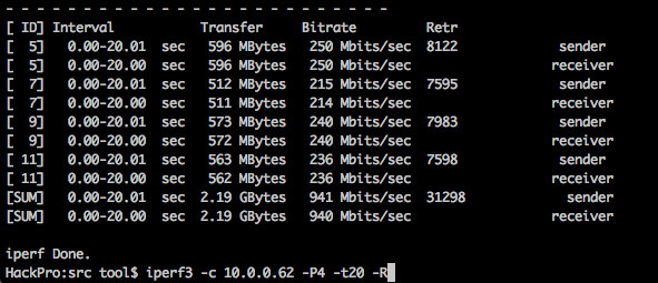

Using: iPerf3 -c N54L-bond -P4 -R
Sending from a 1nic computer, and the bond receives from 4 NICs. I have to test this again changing to L2+L3, but I remember with this setting the server only received through 1 NIC. (As it should).
My concerns are about how this realy behaves, because as you said one single destination shouldn’t work properly with LACP (even multiple connections).
