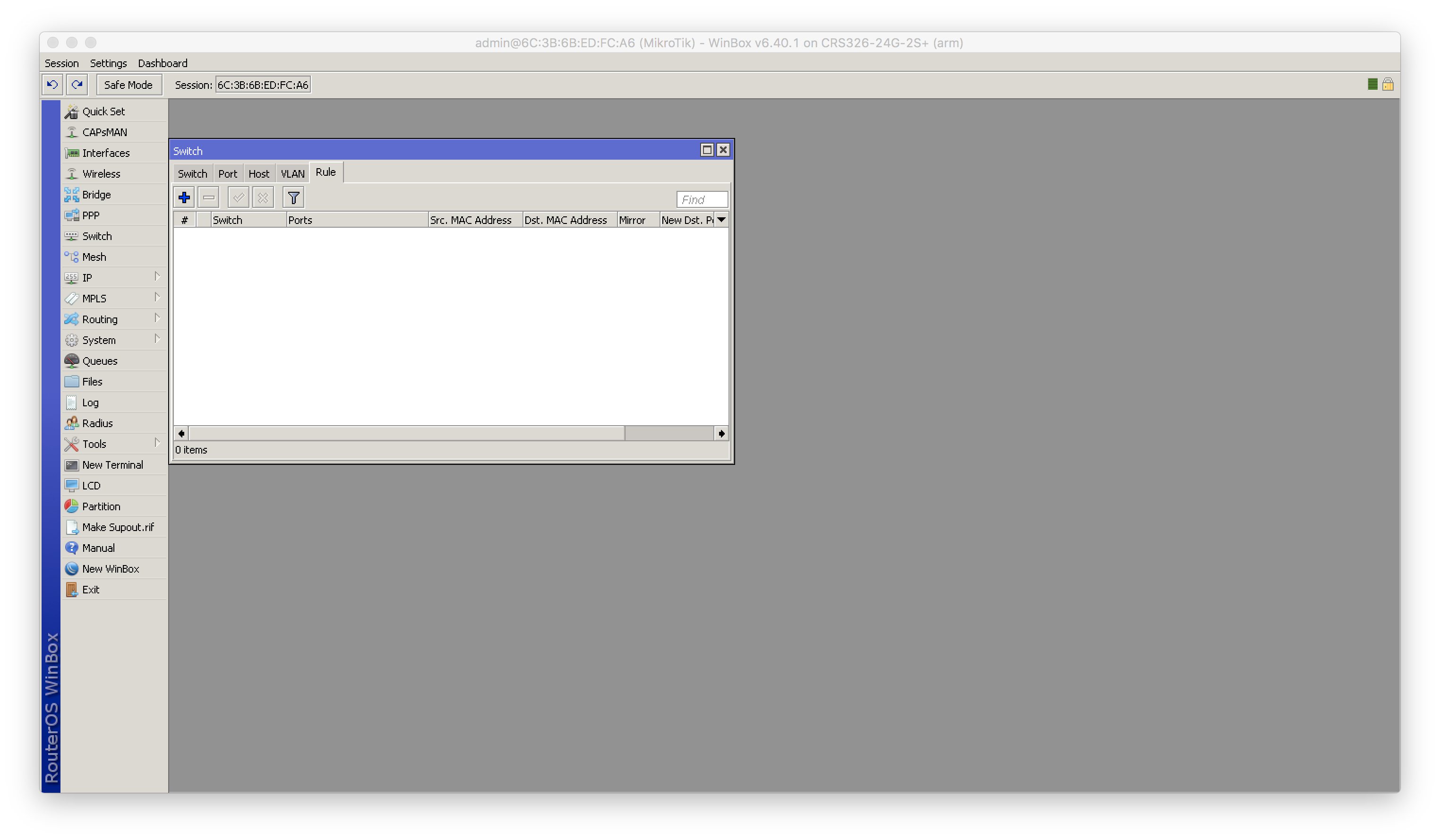

Have a couple of CRS326 (6.40.1) that I bought to replace my CRS226
But the feature I use the most in the CRS226 are the Switch Qos Shaper menu, and that doesn’t appear on the CRS326 in winbox 3.11

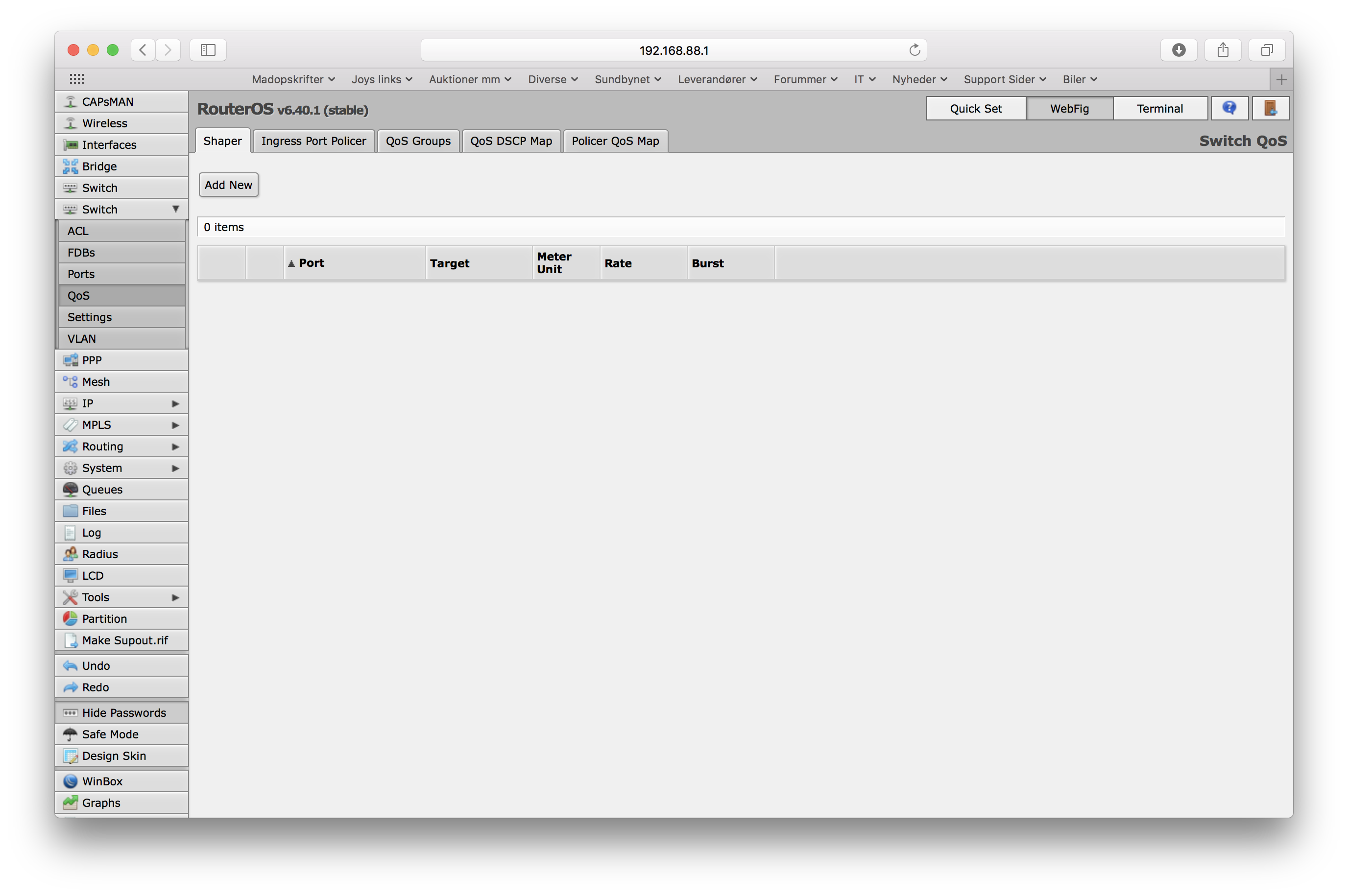

But today I noticed that if I use a browser to access the web fig menu it has 2 switch menu´s, see attached screenshots
In web fig it has the correct menu Switch - Qos - Shaper which is the menu im missing
is this a bug in winbox?
My fear is that it is a fault in web fig, and a feature that will be removed again?
Can Anyone clarify, if the function Switch - Qos - Shaper will remain in the CRS326 and that it is a bug in winbox that It is not appearing?

Did you ever find out about this. I also have a CRS326-24G-2S+RM. We use the CRS226 series and the ACL and Mac based rules all the time. Is this switch going to lose this capability OR is this just a bug in the winbox or something? Webfig does show the switch menu we were looking for but we seem to be missing the options from the command line.

got this reply
At the moment, CRS3xx Switch Rule table can limit Rate in ingress only.
/interface ethernet switch rule
add switch=switch1 ports=ether2 rate=200M
If setup allows, to achieve Rate limiting in opposite direction we recommend to add Rate limit rules on uplink port with additional matchers as dst-MAC or dst-IP.
We plan to implement egress Rate limiting in CRS3xx switches in upcoming RouterOS versions.
