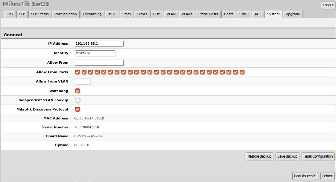

Gustavo told you how to do it from RouterOS.
If you have SwOS now, this is how you do it then (Boot RouterOS button on the bottom):
