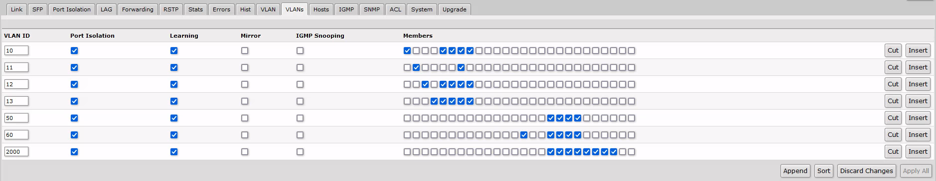

I have VLAN 10 (wan1), VLAN 11 (wan2), VLAN 50 (local network), VLAN 60 (local network 2).
Port 1 (untagged only), Port 5, Port 6, Port 7, Port 8 have VLAN 10
Port 2 (untagged only), Port 5, Port 6, Port 7, Port 8 have VLAN 11
Until now we haven’t used Port 2 (wan2) but it was configured (link down). When the DC staff connected the new WAN connection to Port 2 on this switch both WAN1 and WAN2 experiencing about 48% packet loss.
I have tried to remove all the ports from VLAN 11 except Port 2 but we experience the same issue. If I disable Port 2 everything is normal, no packet loss.

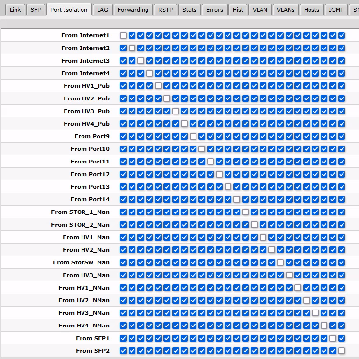

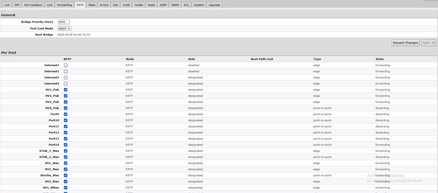

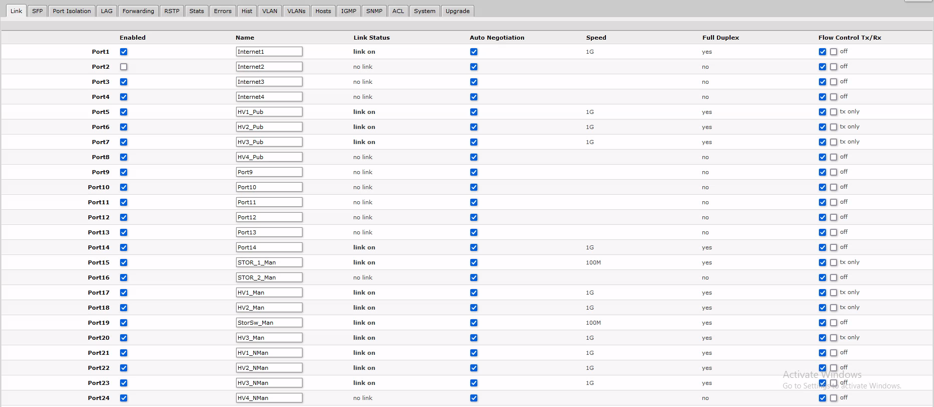

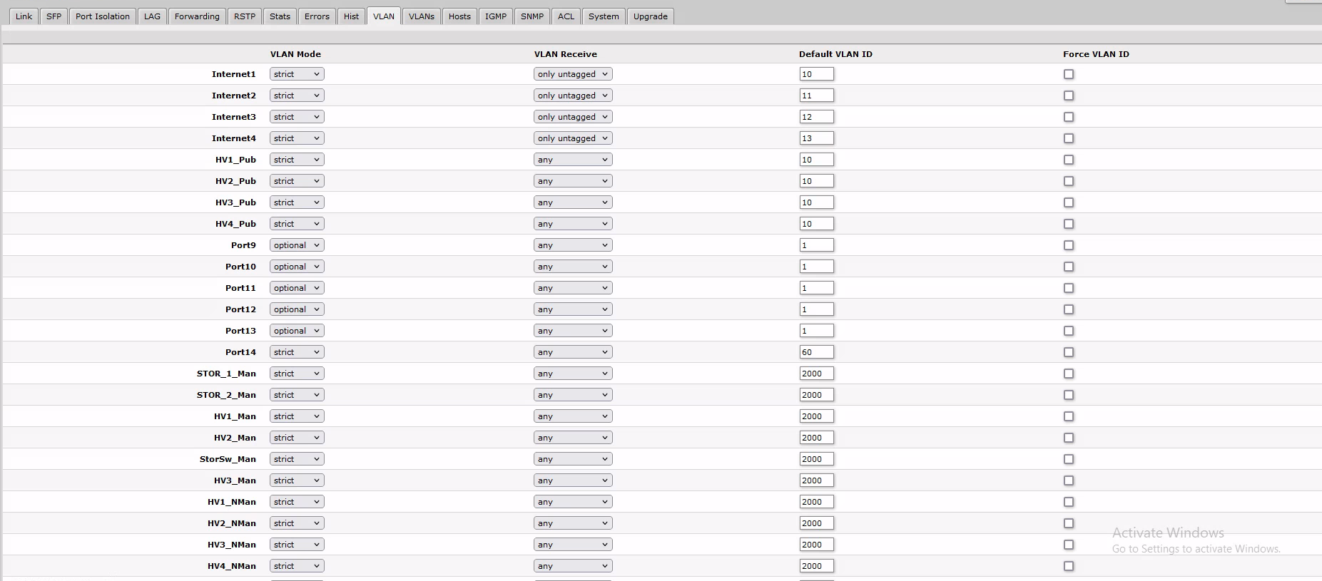

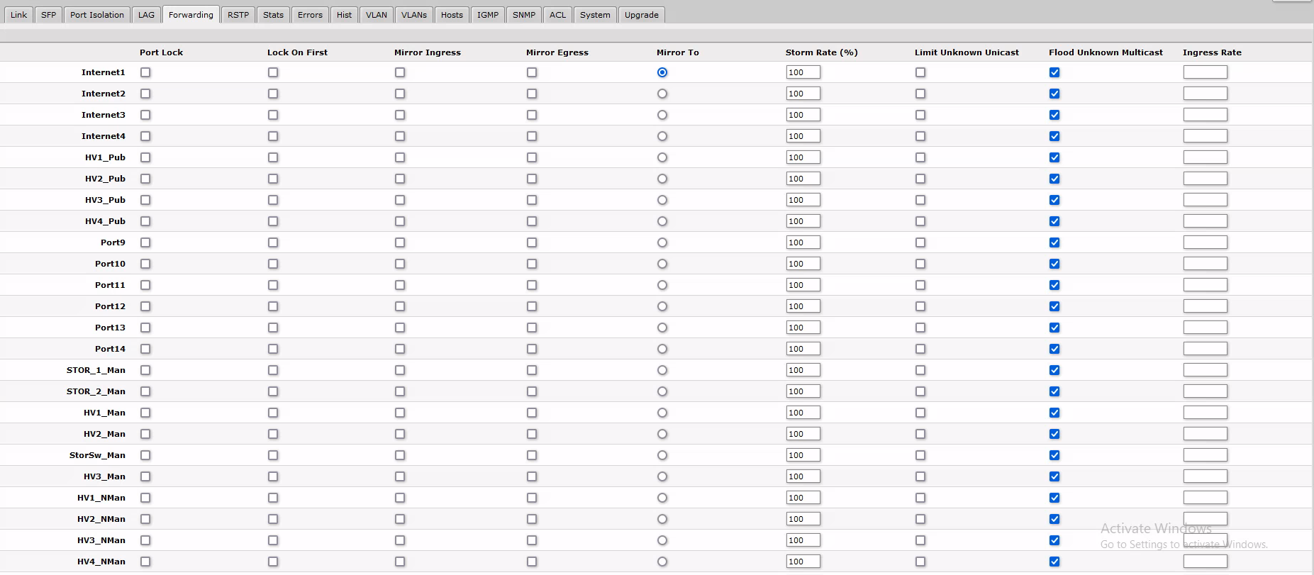

Screenshots of the configuration are attached. (Currently VLAN11 is only on Port 2 and Port 7, but tried only Port 2 ) If you have any idea what could cause this please share it. Thank you!
