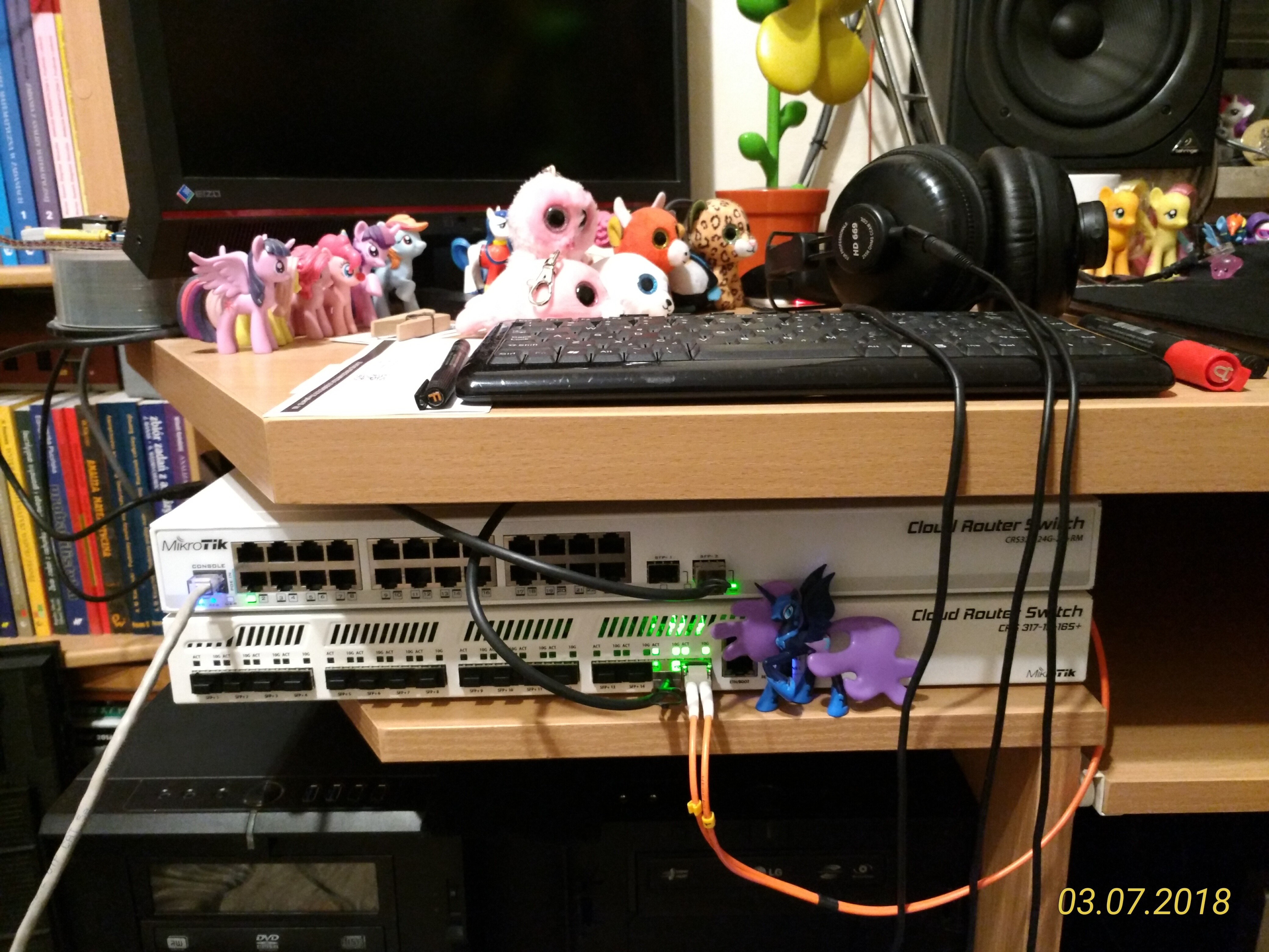

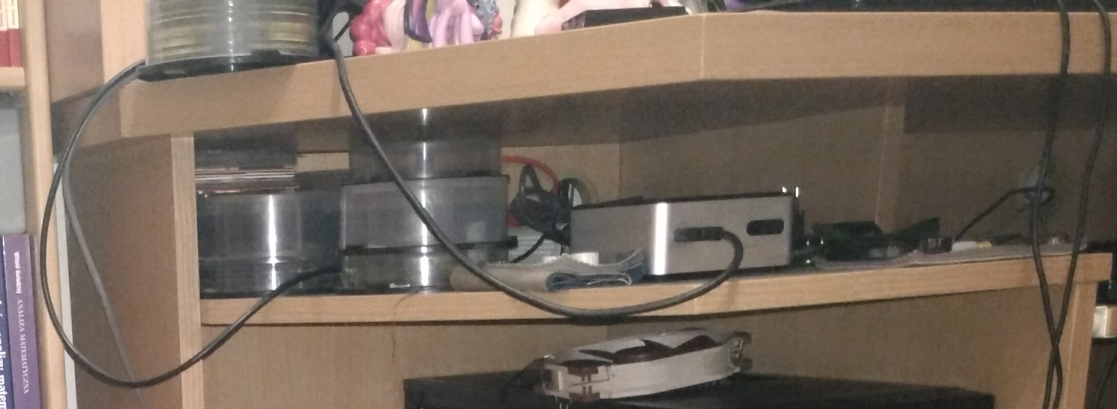

In room probably around 26-ish or something. It’s jsut normal room and it’s summer so… Worse case is temperature inside this desk shelf which i’d say is something around 32-36? maybe. I’m not sure but it feels similar to temperature in workstation chassis where fan controllers probes say 36 deg so I think that would be accurate. There are those 2 switches, NUC with Celeron and Thomson ISP router on this shelf. Latter two are behind switches, you can spot NUC on photo in corner, left up from CRS326. HDMI and USB cables lead to it. Photo of shelf from before I put switches here:
There’s cutout for cables and it’s pretty much the only unsealed area of shelf. Other than that it’s rather closed chamber with only front intake. Of course I took those CD cases out so now there’s nothing except those 4 devices here.
