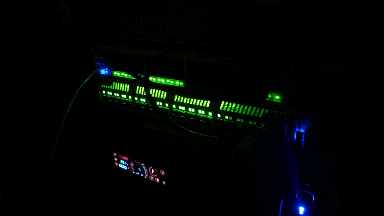

It has actually legit use cases. As I won’t use all ports for now I think I’ll write script that will indicate bridge throughput meter the same way you can indicate wifi signal strength. Or CPU usage. Or some ping monitor that will indicate with leds if certain hosts in network are down. Endless possibilities!
