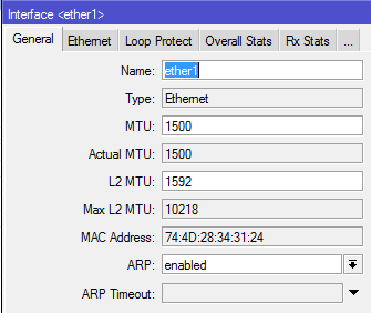

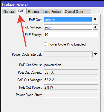

Hello. We bought CRS328-24P-4S + for powering CCTV cameras. As I initially understood, he has PoE on all ethernet ports. But for some reason, from 1-8, the PoE port does not work and it is not even in the tabs. From the description, I realized that all ports are divided into three groups and each has its own PoE with a budget of 150V. It is possible that a group of ports with 1-8 does not work or does not have PoE. If so, can I change it under warranty? Or is this model the first eight without PoE?
