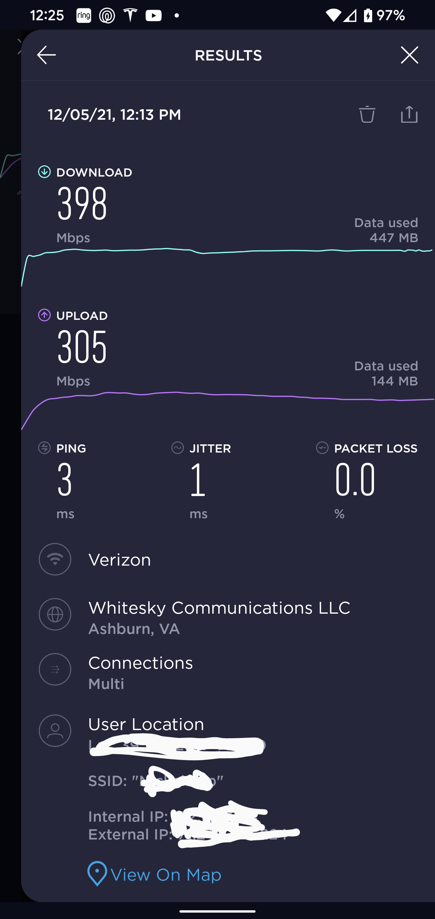

I got almost 20% more thruput after updating to 7.1+ Wave2 =)

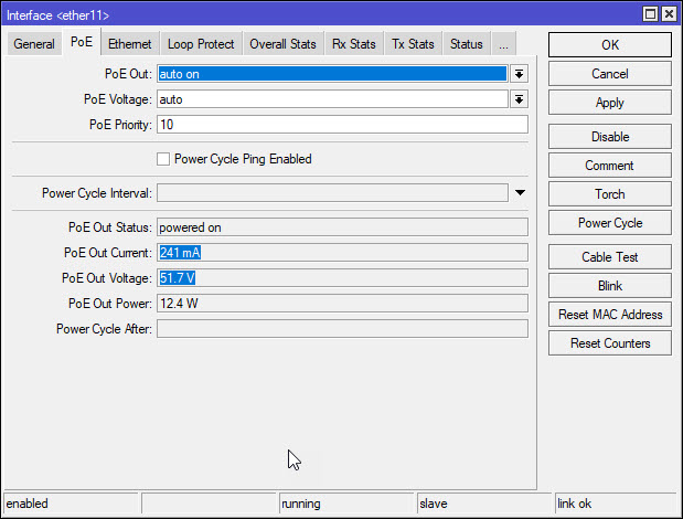

I did some Quick Power test (CAT-6a Cable ~20m 51V)
Laptop and phone during Low-Traffic ~ 6W of Power is needed,
Laptop and phone with medium Traffic up to 14.3 W
average ~ 12 W

    I did some Test yesterday…
    I wasn`t able to reproduce the PoE-Overload on any
    of my Mikrotik PoE-Output devices.
The Mikrotik website states a Max power consumption of 21Watts (30W for LTE version)
During my quick tests , i wasn*t able to exceed 14.5 Watts.

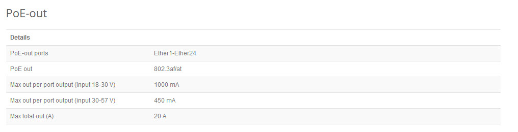

Mikrotik say the Audiance can need up to 27 Watts :frowning:
Even the CRS328-24P-4S+RM can`t provide that kind of Power.
Yup..
27 vs 25.5
Thats what kicked the voltage overload, and shut down from the switch.
I have another WiFi running the house at the moment… so i can’t test that low power setting right now.
@smyers119, That strange the Mikrotik Website, says something else
I don`t know if i can edit the Voltage, but my CRS328 provides 26V & 52V
That would mean,
High-Voltage = 52 V * 450 mA = 23.4 Watts
Low-Voltage = 26 V * 1000 mA = 26 Watts
