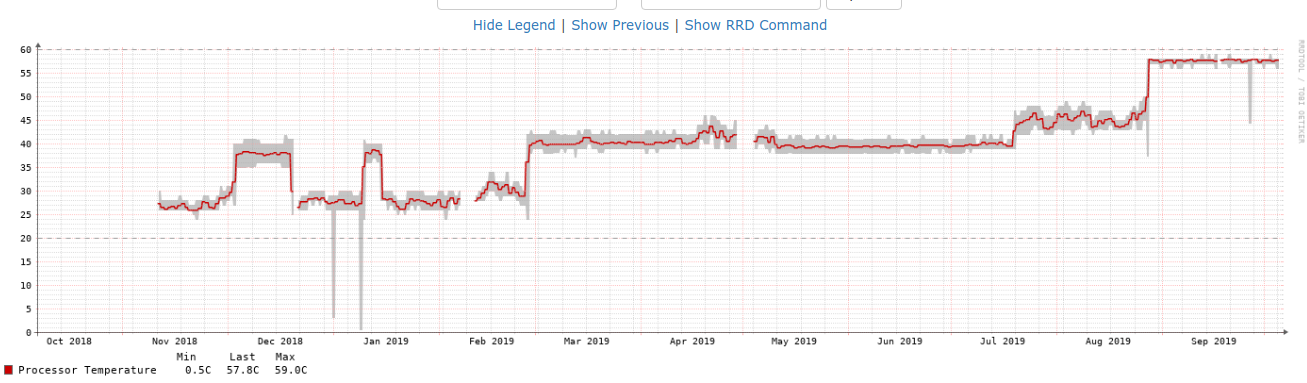

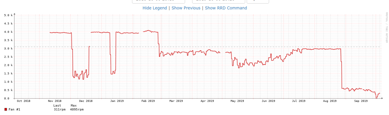

To be honest if you’re running RouterOS then make sure you’re running the latest version and you won’t have to swap out any fans.
Whatever changes they made means mine is practically silent with fans running at 270RPM instead of 4000RPM.
Of course this is at the expense of temperature which is now 58 degrees instead of somewhere in the 40s.
What version are you using and can you post screenshots of /system health?
As @elbob2002 have said - in latest versions there were improvements which affects fan speed based on temperature.

Hey - Could I ask how you accessed those graphs ? Is it within the RouterOS Software or some other 3rd party?

Sure - I’m using LibreNMS. SNMP monitoring of RouterOS.
Unfortunately if you’re using SwOS then SNMP is quite a bit neutered.
