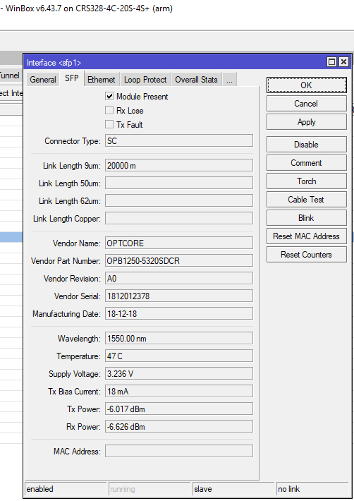

I have the same problem. Using cooper 10 GB cable is ok, but on using SFP Fiber 10 Gb not working. I try many settings.
I have same issue with SFP ports. Tested on 6.43.7 and 6.45.beta50.
If auto negotiation is enabled - no link
If auto negotiation is disabled - port is running but no incoming traffic
