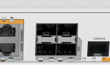

I have someone at a remote site verifying where cables are plugged in, we have a CRS328-24P-4S+RM.
The manual contains no pictures of the device, and we need a clear and unambiguous description of which port is which. Is sfp-sfpplus2 the top left SFP+ socket, or the bottom left SFP+ socket? The labelling on the switch is stylised and unclear.
Can anyone confirm?
I would think the bottom is 1 and the top is 2.
That is also the way our new CCR2004 is numbered (I did not expect it because for other manufacturers the top is the lower numbered port)

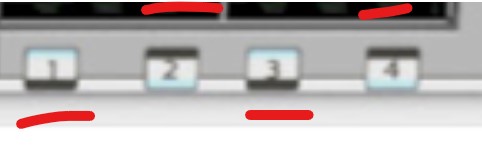

If you see the pic below the port the bold black line shows which port is the Nr1 and which port is the Nr.2
