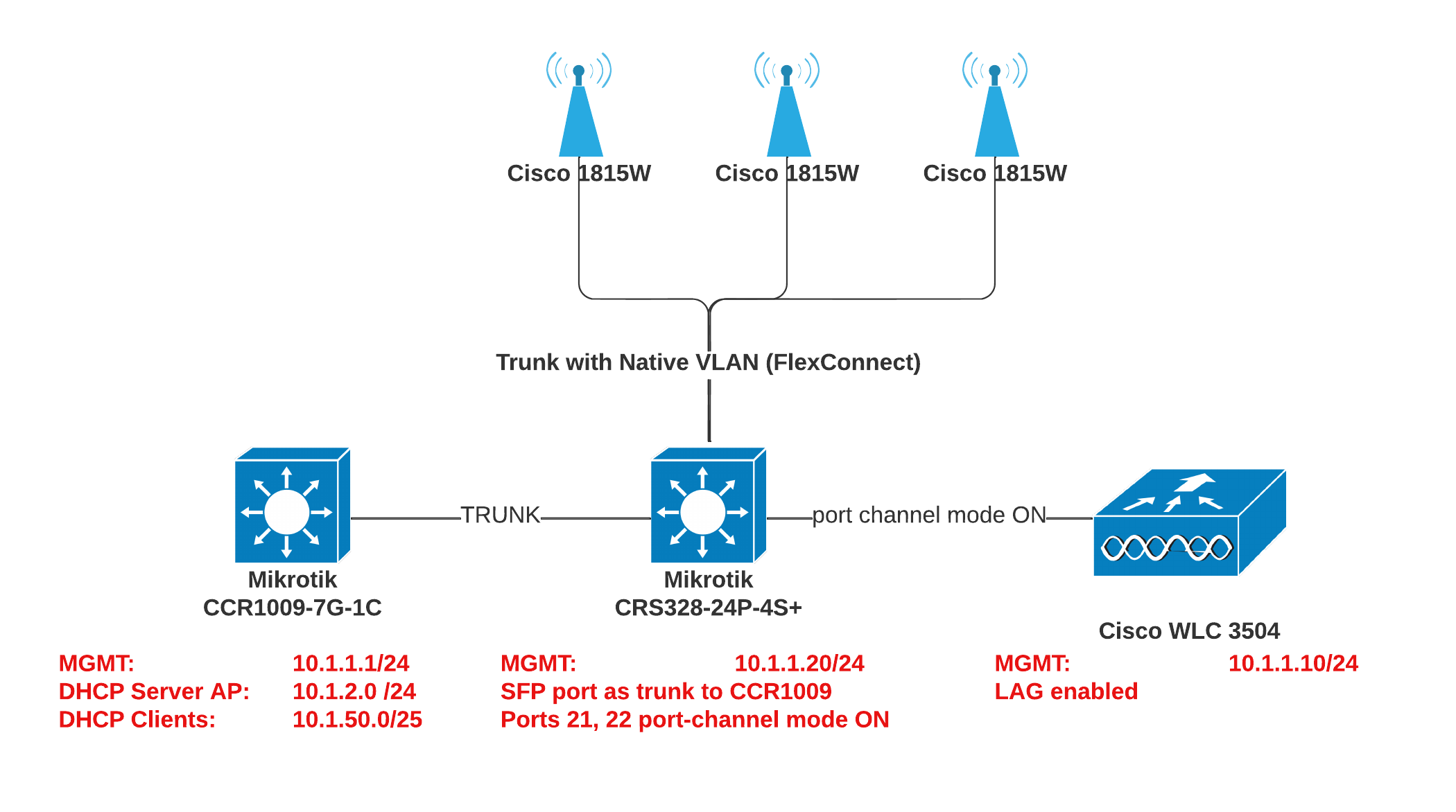

I have a question for those that have tried to connect a Cisco wireless lan controller to a Mikrotik switch

The topology I have is the one attached to this message, let me know please if you had the same issues and how did you solve to connect a Cisco wireless lan controller to a RouterOS switch like CRS328, the one I have.

Thank you for the link https://www.firewall.cx/cisco-technical-knowledgebase/cisco-wireless/1223-how-to-configure-wlc-lag-and-port-channel-with-nexus-catalyst-switches.html, but as you have seen the port-channel must be ON on the Mikrotik side and I don’t think that Mikrotik supports that since I haven’t been able to find any documentation about it.
I will try tomorrow to disable LAG and have the WLC connected over a simple trunk port. I don’t see any other solution, but it would be a pitty to have 4 links that can be aggregated but unusable because Mikrotik doesn’t support port-channel mode ON.
port-channel mode is CISCO only Protocol, is like saying it is pity that I cannot use a catalyst 7500 chase, full of Cisco hardware because it does not know EOIP.
Nope, but I was under the impression that LACP mode ON is under the open source protocol 802.3ad but it seems like is not. Therefore, I’ll give it a try with the WLC being configured without LAG and the SW with a trunk port and see if it works.
