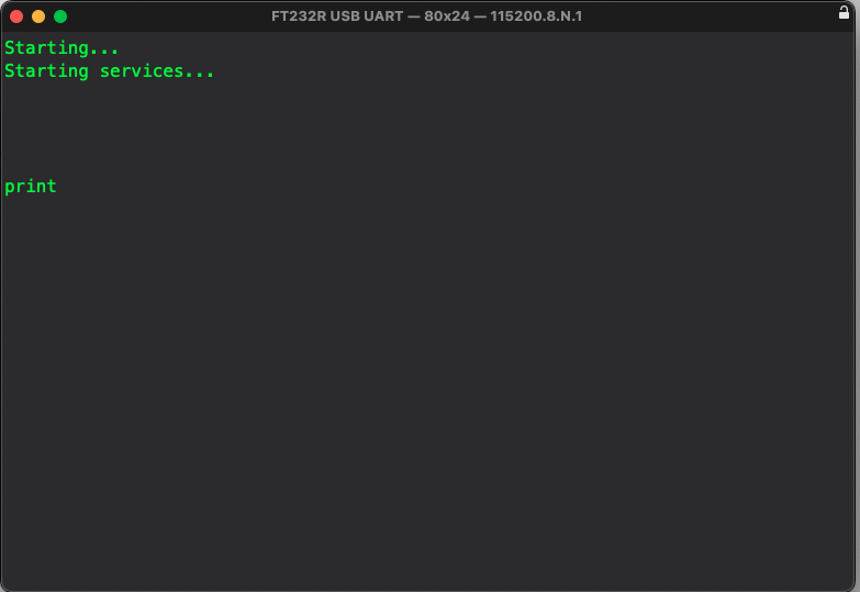

I can not get the console cable to work with this switch. I have a CRS317 and Crs328-24p on the same rack and the same console cable works just fine. I tried updating the ROS on the problematic switch and the boot up on the screen works perfecfly but when the switch loads up. I can work on it from the WINBOX but I can not use the console. Im trying to do some quick paste configs and without the console it proves to be tricky. Has anyone seen this before. It stays stuck like in the image im attaching.

if for some reason on RouterOS terminal on serial port is disabled, or the serial is used by another service, you see nothing after RouterOS end loading…
