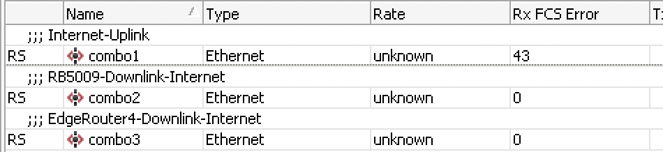

I am seeing something weird. I am getting my internet handed to me on a copper port to this switch that I was going to use just layer 2 the publics to the 2 routers im using. But Im getting these FCS errors and the Rate is unknown and it doesnt show that the port is connected at any rate.. When I asked the ISP to check their switch they are not seeing any errors and say that they are connected at 1gig full duplex.

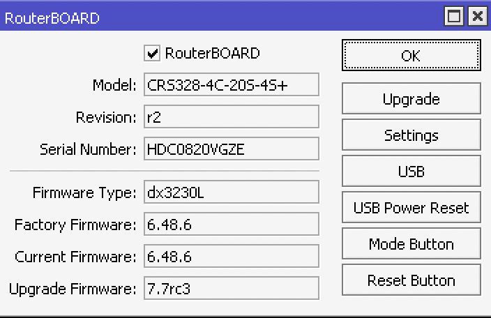

I was curious as to why my switch isnt showing that. Or the connection to even my routers. the RouterOs Version is
7.7rc3
and the Firmware is at 6.48.6.
I dont know if that has something to do with it. But I was wondering if I could maybe get a little guidance as some steps I could take to understand what is going on .
set [ find default-name=combo1 ] advertise=10M-half,10M-full,100M-half,100M-full,1000M-half,1000M-full arp=enabled arp-timeout=auto auto-negotiation=yes bandwidth=\
    unlimited/unlimited combo-mode=auto comment=Internet-Uplink disabled=no full-duplex=yes l2mtu=1592 loop-protect=default loop-protect-disable-time=5m \
    loop-protect-send-interval=5s mac-address=**:**:**:**:**:**:** mtu=1500 name=combo1 orig-mac-address=**:**:**:**:**:**:** rx-flow-control=off sfp-rate-select=high \
    sfp-shutdown-temperature=95C speed=1Gbps tx-flow-control=off
set [ find default-name=combo2 ] advertise=10M-half,10M-full,100M-half,100M-full,1000M-half,1000M-full arp=enabled arp-timeout=auto auto-negotiation=yes bandwidth=\
    unlimited/unlimited combo-mode=auto comment=RB5009-Downlink-Internet disabled=no full-duplex=yes l2mtu=1592 loop-protect=default loop-protect-disable-time=5m \
    loop-protect-send-interval=5s mac-address=**:**:**:**:**:**:** mtu=1500 name=combo2 orig-mac-address=**:**:**:**:**:**:** rx-flow-control=off sfp-rate-select=high \
set [ find default-name=combo3 ] advertise=10M-half,10M-full,100M-half,100M-full,1000M-half,1000M-full arp=enabled arp-timeout=auto auto-negotiation=yes bandwidth=\
    unlimited/unlimited combo-mode=auto comment=EdgeRouter4-Downlink-Internet disabled=no full-duplex=yes l2mtu=1592 loop-protect=default loop-protect-disable-time=5m \
    loop-protect-send-interval=5s mac-address=**:**:**:**:**:**:** mtu=1500 name=combo3 orig-mac-address=**:**:**:**:**:**:** rx-flow-control=off sfp-rate-select=high \
