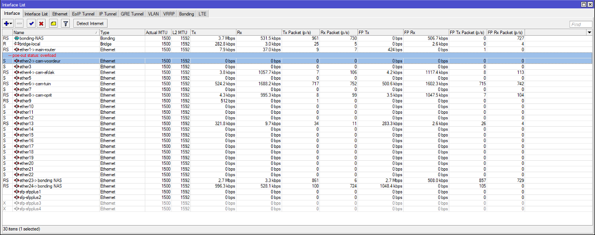

But Grandstream camera’s don’t work and the CRS328 Give error overload.

hi, you must set PoE Out : to “forced ON”
I have this errors on couple of my switches but this was always solution for me.
