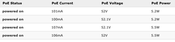

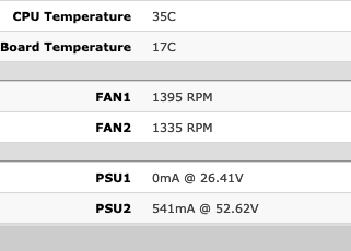

If the wifi is loaded during the day, it comes to these failures. My fear is that then more current/watt is needed via POE, so that CRS328 can not cope with it and then simply disconnects the connection to not overload the power supplies (or whatever).
