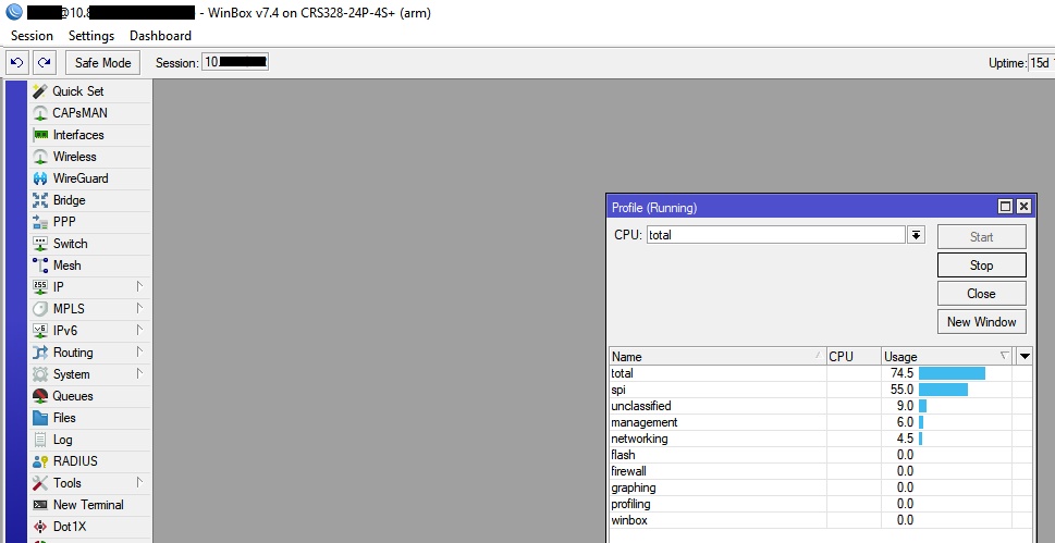

CRS328 / high CPU-Lod SPI
does anyone know why the process “SPI” creates such a high CPU-Load? Sometimes it goes up to 100%
I have read this is LED related, but the CRS328 does not have a LED screen.
The config is 1:1 the same as on a replaced CRS326, this never showed SPI.

The question is, what is SPI at first? MT does not clarifiy?
https://wiki.mikrotik.com/wiki/Manual:Tools/Profiler
Normally SPI stands for “Stateful Packet Inspection” but this device is configured as a simple switch, no NAT, no filter, no mangel… So SPI must be something different. Maybe someone knows?

http://forum.mikrotik.com/t/system-profile-spi/152663/1
SPI = https://de.wikipedia.org/wiki/Serial_Peripheral_Interface
sometimes when there is a high activity over storage SPI shows high usage
Provide a config export.
As chechito says. The flash memory sits on the SPI-bus. Are you using the flash memory for something?
