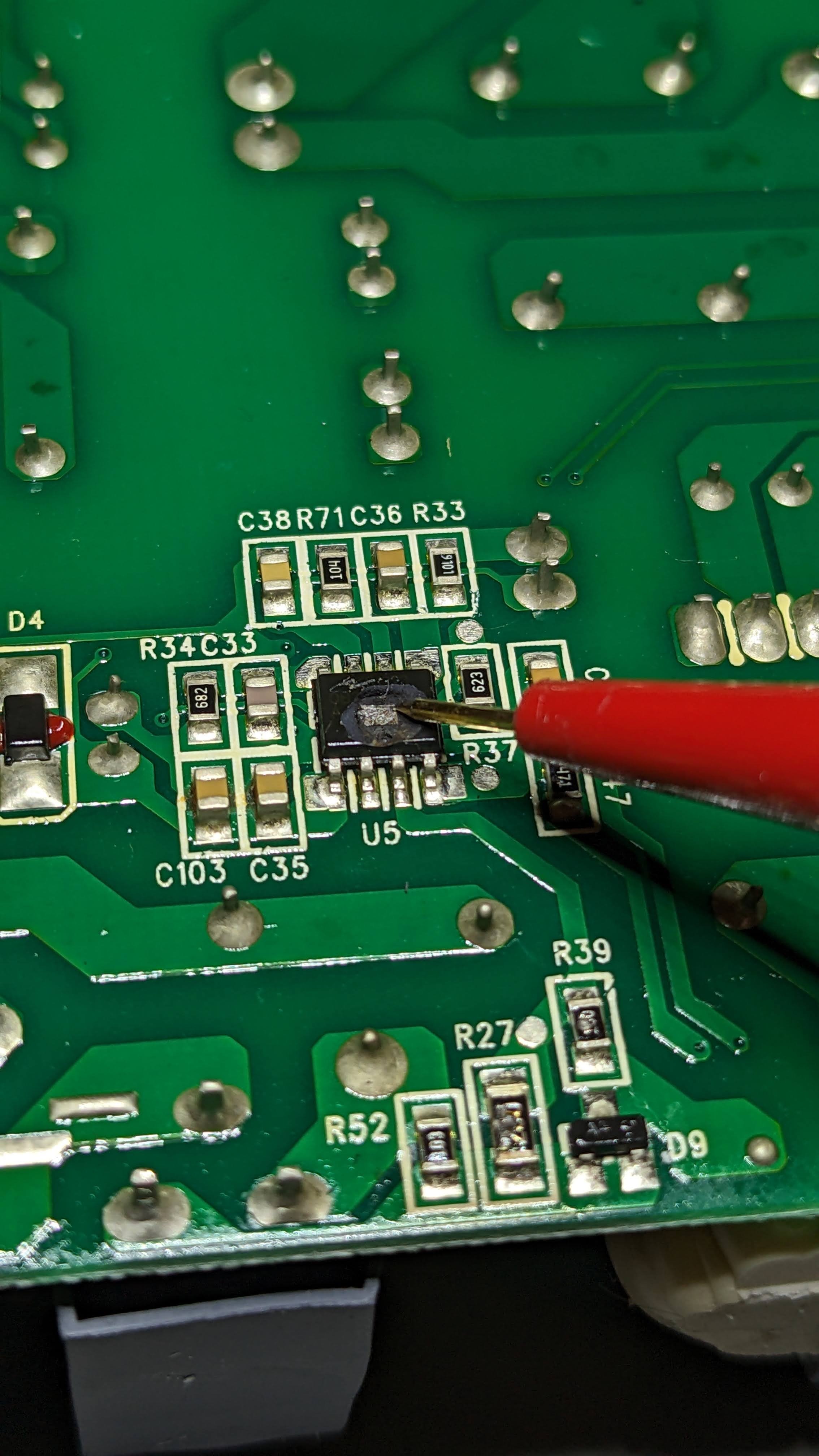

Does anybody know what U5 component is (bottom of the PSU board, roughly in the middle of the board) - see photo? Mine blew up and can’t really tell what it is. Also - the values of the resistors nearby (R27 and R39 - see the photo) which alse seem to have blown up… And finally - that diode nearby the resistors…
Perhaps somebody has a disassembled PSU and could make a photo…?

The burned resistors and diode seem to be part of the gate drive circuit of a power MOSFET or IGBT which got shorted too. The unknown chip could be a PWM or PFC controller, if pin 1 is upper right then quite a few PFC controllers (L6562 for example) have gate drive output on pin 7 (between ground on pin 6, and power on pin 8 ).

If I guessed right and it’s an active PFC, you could try to bypass it (remove the shorted MOSFET) and the next PWM stage might work at slightly lower voltage (not boosted by PFC, just peak rectified from the mains - PFC is mostly there for compliance with harmonics regulations to make the power utility company happy) if you don’t try to load it to the max power. It may or may not work, it really depends on the design though.

And yes - that chip seems to be driving a mosfet (which is indeed shorted and I think the whole catastrophy started at that mosfet and it’s the root cause). But I do t want to try and guess what that chip was (or try to replace ot with something else) because it’s a nice power supply and I dont want to cause more damage…

The cause of the MOSFET short could be AC overvoltage (lightning strike, loose neutral wire, wrong settings of nearby PV inverter to sell more solar power to the grid, etc.), but also another failed component that could open the feedback loop so it was trying to boost the voltage too high. Low power resisitors working at high voltage (like in a feedback loop voltage divider) sometimes fail open without overheating or any visible damage.

The layout looks similar to your picture. So I disassembled my CRS328.
The IC should be OB2276CP
Unfortunately the circuit board was covered with a varnish and the inscription is hardly readable.
