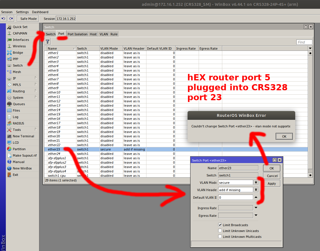

I plugged port 5 of an hEX router properly configured to handle 802.1Q trunking for VLAN20 to ether23 of the CRS, so far the router doesn’t receive anything from the CRS… I went to the switch menu “port” tab and tried to put “vlan mode” to “secure” (for the hEX router port): whatever i do in this menu end up with “VLAN mode not supported”. So for now it doesn’t seem i can do hardware VLAN / QoS.

Throughput rate limit is not QoS!!! I don’t understand why they’re talking about QoS in that way… To me, QoS is priority level. I saw VLAN-Priority in the documentation but didn’t find anything about how the switch will effectively handle this (if at all).
