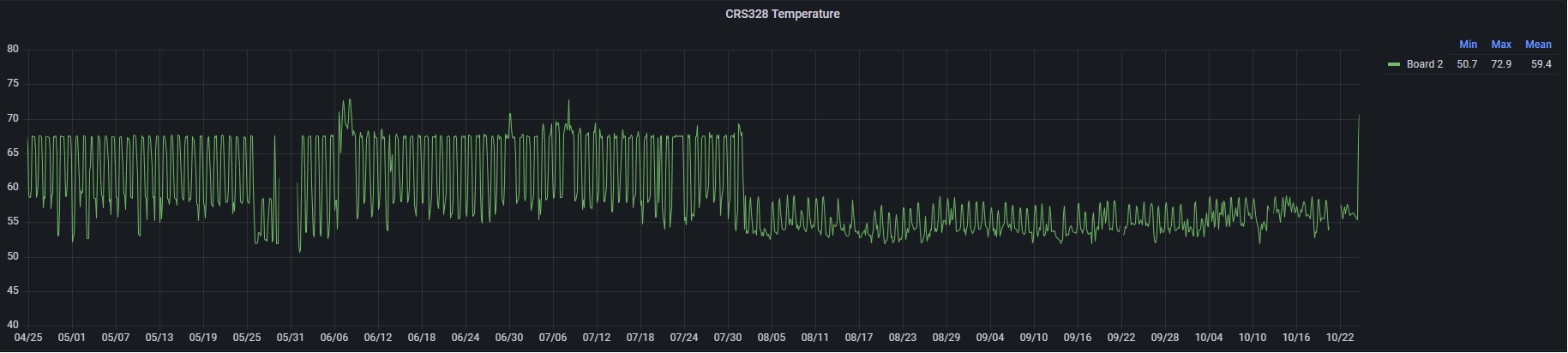

Ok I know this is really old, but i have an update on this. This problem of high temperature went away when I had upgraded the packages to the next RouterOS version (6.47.1) This was end July. This was smooth for a few months and now i again upgraded to the newest version of the RouterOS (6.48.5) and the problem is back. The temperature for board 2 is showing around 70C. Is this a RouterOS issue or is the reporting incorrect. Please find attached the temperature graph measured over the last 6 months. Did something change in the latest version of RouterOS ?
