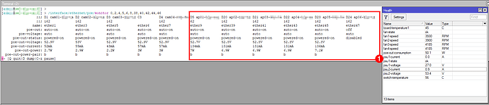

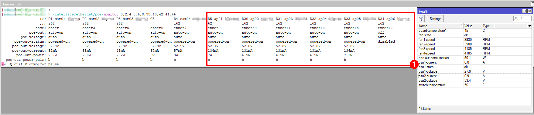

The device is rated for 700W total PoE output.
From the post it has an isssue when only 5x3+5x7=50W are actually used.
There is an issue.
Difficult to say if actually related to PoE power of the device (as the screenshot looks fairly normal) or to something else.
With all due respect, if I had spent almost one thousand bucks for a powerful PoE switch, I would expect it to work as advertised, and be capable to power more than 1/10 of what it should, suggesting to use external PSU's seems to me inapposite.
PSU2 current is 0.9A out of the 13A available for powering access points and other network devices.
