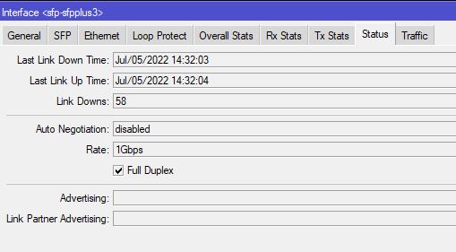

Since then we have massive problems with SFP.
What kind of problem ?

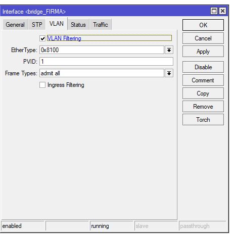

Also i think you could configure your VLANs in a better way…
Although adding VLAN interfaces as Bridge ports is not wrong, there are cases it could cause problems…
You can read here https://help.mikrotik.com/docs/display/ROS/Layer2+misconfiguration
Why don’t you use Bridge VLAN filtering ?
SFP Problems, we have many Link Downs. With version 6 everything still worked.

Since Bridge VLAN filtering is not enabled ( and CRS3xx devices support bridge VLAN filtering in Hardware ) all the VLAN handling is done in software to the CRS…
Is that ok, can you switch it on in live mode?
No…
Read here https://help.mikrotik.com/docs/display/ROS/Bridging+and+Switching#BridgingandSwitching-BridgeVLANFiltering

But my bigger problem are the crashes from the SFP. Could the problem be in the bridges? or what else can I do?

What can trigger the SFP flapping? Everything worked until 6.48.6. We’ve only had problems since the update.
With other networks, however, everything works with the same hardware.
We only have CRS3xxx and S+85DLC03D, autosense off and manual on 1GB.

There are cases, e.g. on Routers that might have Bridge VLAN filtering enabled, where the Bridge must be added as Tagged member for all the VLANs configured so that they are able to access the CPU… Otherwise those VLANs that the Bridge is not added as Tagged member won’t get IP services…
Nice topic to read is http://forum.mikrotik.com/t/using-routeros-to-vlan-your-network/126489/1
Why 1 and not 10Gbps ?
With 1 GB the flapping was less. Unfortunately, the flapping is not just on one port. But in the whole network, on different switches. I.e. there can be no MiniGbic module defect and also no cable. Can something like RSTP possibly be the reason?

CRS3xx series support only ONE hardware bridge. Others get software-forwarded and, therefore, software-routed. So the rule of thumb is to have only one bridge, segregating networks with VLANs (vlan-filtering=yes). If you need Inter-VLAN routing, add the bridge interface itself to the tagged members of the VLANs.
“/interface ethernet switch vlan” is a legacy option (e.g., for CRS1xx/CRS2xx devices). CRS3xx series use the new VLAN configuration via “/interface/bridge/vlan”.
L3 Hardware Offloading Wiki
