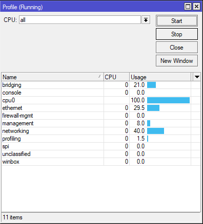

I have a CRS354 on 6.47.9 that’s constantly running at near 100% CPU usage. It doesn’t do any routing except for management access, and as far as I can tell, only WinBox traffic is going on. I’ve not noticed any issues with switching performance, and it rarely gets more than a few GB/s. WinBox is slow as a result, and just exporting the configuration took like a minute or two.

Issue remains. I’ve not been able to verify, but now I’m starting to suspect it is in fact affecting switching throughput. It is very much a production device and cannot be taken down for maintenance on a whim.
Anyone got any ideas?
Well my guess is there that somehow hardware offload is not active on a port somehow.
If you run the following:
/interface bridge port print
Do you then get an H marked before all ports? My guess is that some port is not and for this reason traffic hits the CPU.
Bonding and LACP should provide hardware offload but take a look and see if any port is not active in regards to hardware offload.
Thanks. All enabled, active bridge ports seem to be hardware offloaded.
