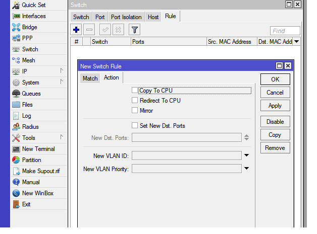

maybe switch rules can help??
I tried ‘naive’ way of switch rules aka force the same dst-port as source port without vlans and it didn’t work (switch didn’t reply to the same port) but hm… I didn’t try to do that with MAC vlans enabled. That could possibly work. I’ll try. Though MAC vlans itself are accomplished using switch rules so I sense possible difficulties.
