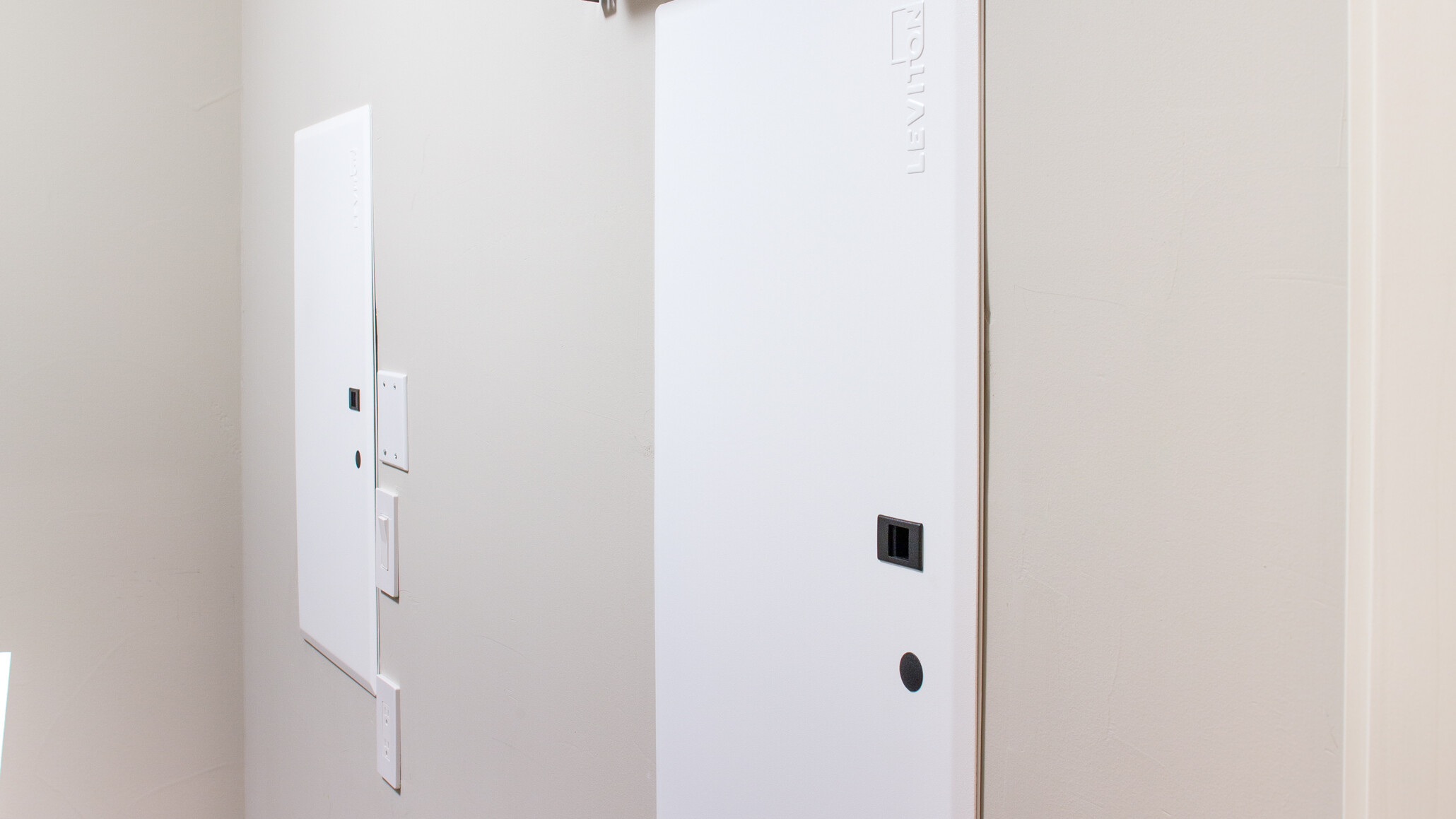

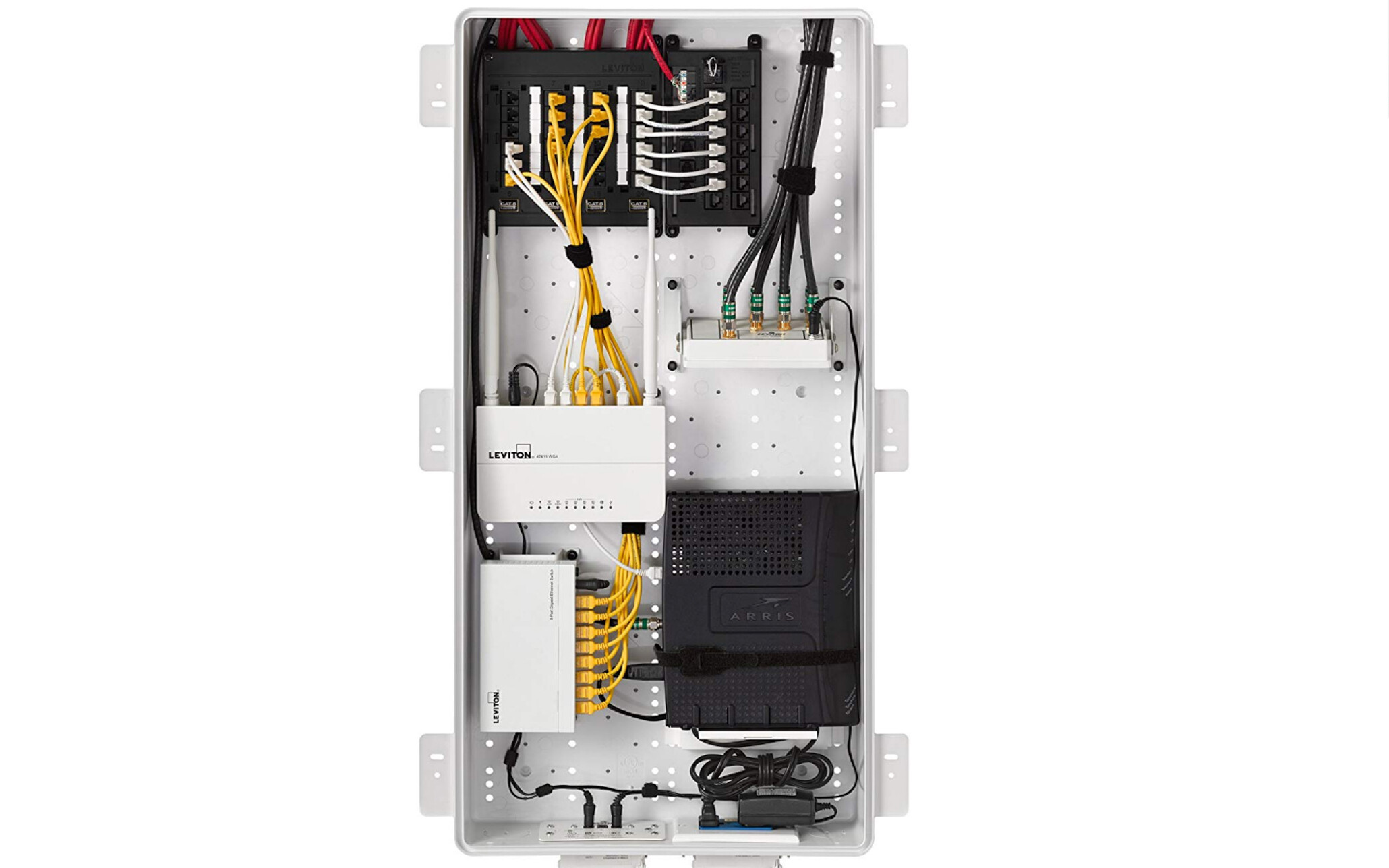

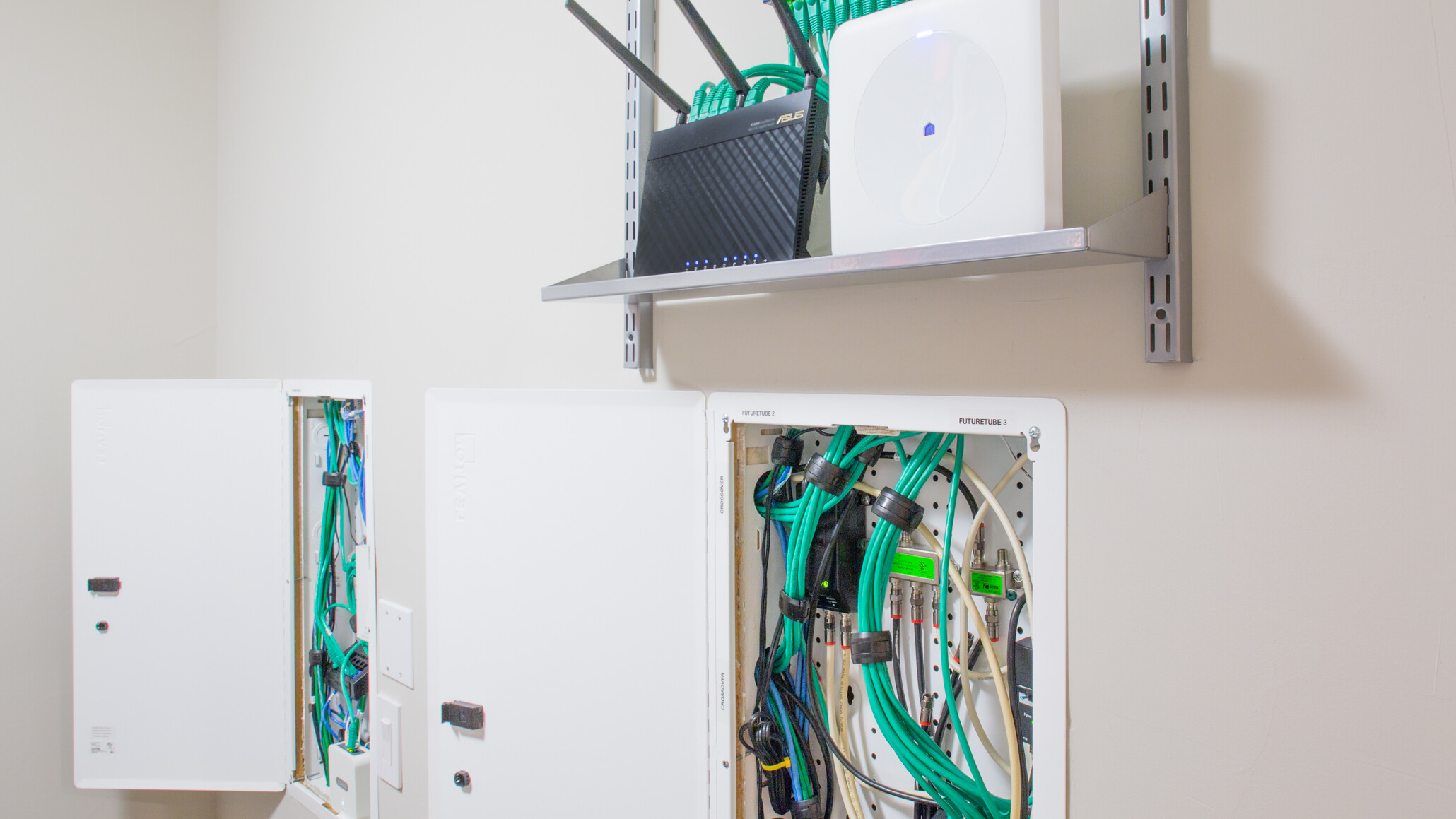

I need the smaller form factor of the -IN model for the in-wall equipment cabinets found in most homes (at least in my experience in mid/high-end homes in the US)… like the Leviton one linked below (pic attached for posterity), in which it is very difficult to fit even the smallest 24-port rackmount switch (MT/Cisco/etc, doesn’t matter) with any space left over for other equipment, which I usually need, like POETexas injectors, power bricks for other gear, power strips, etc. The CRS125…-IN is what I use now and it’s a good size… has room around it for cooling and some slim other stuff if need be (power bricks/etc) and fits right in the center of the top usually, facing down for easy access plus the screen is accessible (not as worried about having a screen, but it’s a nice touch for this mounting arrangement.
Current link to article with sample pics (same as attached): https://digitized.house/future-proofing-your-smart-home-with-structured-media-components/
