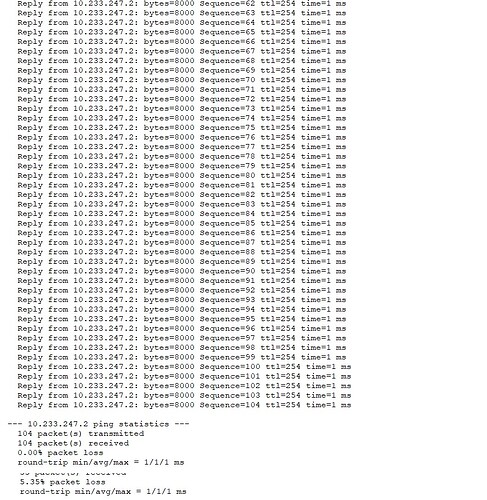

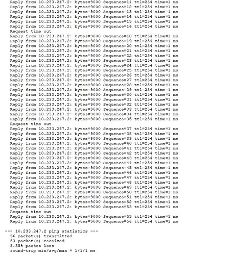

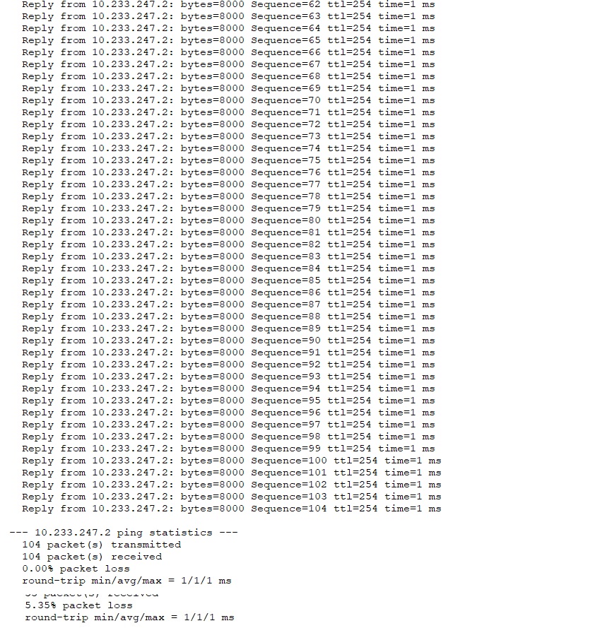

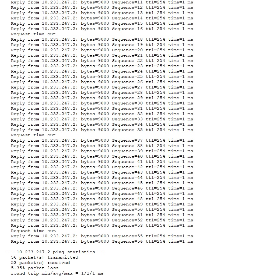

CRS504-4XQ dropping packets with mtu at 9000
I have a P2P with CRS504-4XQ configured as an L2 switch, l2mtu set to the maximum 10218, but when I test ping using mtu at 9000 it loses many packets, the interfaces are configured as 802.3ad bonding, the current version is 7.19.6, when I test mtu at 8000 it does not lose packets, as per the attached prints, is there anything I can do to resolve this?
