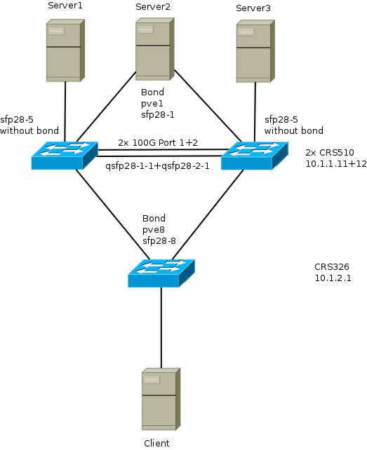

i have this setup similar here:
https://help.mikrotik.com/docs/display/ROS/Multi-chassis+Link+Aggregation+Group
ros 7.8
my setup at the moment:

my problem:
i ping from my client below the servers above.
that works but with 2-8% packet loss.
it seems that the arp table of both crs510 is not in sync or arp times out.
i tried the bond from crs326 to the both crs510 to switch from 802.3ad to active backup.
its a litte bit better. but from my client i can’t after that change the ip auf the switch to never reach.
whats wrong ?
Thomas
