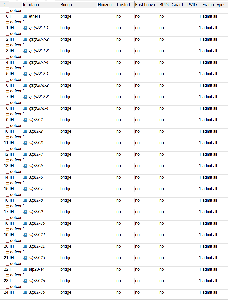

I setup a CRS518-16XS-2XQ for connecting 6 ESX servers for initial staging with 14x 10GbE. For staging , i use also one 1G uplink to connect the staging notebook. The switch runs in bridge mode and has the latest stable fw installed. I reset the switch before and i only configured the IP for mgmt-access. The rest is pretty default (all ports are associated to the default bridge).
All server nodes connected on 10GbE can communicate with each other, but there is no package forwarded from the 10G to the 1G ports. I tried to connect the staging laptop to the management port or using a 1G copper tranceiver with no success.

All ports are belong to the same bridge, no VLANs (PVID is vlan 1)
eth1 is 100M out-of-band management port without direct connection to switch-chip and it shouldn’t be part of “main” hw-offloaded bridge

Can’t really help you, but in your screenshot HW offloading is disabled for sfp28-15. Is there a reason for that?
