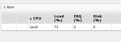

We found that in CRS518-16XS-2XQ, for every port with a module inserted, even with NO traffic flowing, there is an addition 5-7% of CPU usage!
It’s not a problem with a specific board: we verified this behaviour with three different CRS518 boards.
It’s NOT a problem of configuration: we loaded ROS 7.10 and RESET the configuration, so that NO CONFIGURATION is present. With no port connected we have 0% CPU usage. With each port connected we have 5-7% more CPU usage. With 3 ports connected (NO traffic flowing!) we have 15-20% of CPU usage!
As you can see, no IRQ usage, only CPU.
