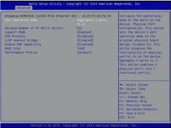

I have this cable and a broadcom 57608
(LRES1260PF-2QSFP112) which does physically has 2x200g ports, and supports “aggregate 2 ports to 1” via uefi setting
In this mode the 2x200g to 400g DD cable from fs.com does not work with the 400g DD cable into the CRS812 side. Running 7.22.1 (stable)
This nic works fine in not-aggregate mode (2x 200g independent ports) with 200g AOC cable.
When in this mode the vendor name and other info about the length, power, voltage and temperatue of the QSFP module is not reported. Says initalizing. Which makes me think possibly it’s a firmware bug or a problem detecting the cable itself and there may be hope for this working in 400g “aggregate” mode instead of 2x200g as shown in patrick’s video?

Because this particular nic does not physically accept 400g dd connectors? There's two versions of this nic one with a single qsfp dd connector and one with two qsfp connectors.

No; I want to use the 400g port at 400g. It is 400g QSFP56 DD but the device I have is QSFP56/112. So the broadcom nic I have is physically incompatible with QSFP56 DD but does work with QSFP112.
I think (?) a cable like: https://www.fs.com/products/352443.html would work where one end is QSFP56 DD and the other end is QSFP112/400g.
However the cable I was originally talking about is a more “ideal” connection here because one should be looking at it by lanes and not data rate. The singular QSFP112 mode has to be stepped down to twice as many PAM lanes (8 vs 4).. hence why that cable is so expensive vs the other cable I linked.
I think the problem is on the mikrotik CRS812 side given it works in 2x200G mode but does not work in aggregate mode to be one physical interface.
And the real-world difference is that the $1500 cable works (because QSFP112 is 4 lanes at a faster rate stepping down to QSFP56 in 8 lanes at a slower rate into the QSFP56 DD on the mikrotik side) whereas with the cheaper cable it’s just 2 sets of 4 lanes, one set from each physical connector on the broadcom nic, into the QSFP56 DD, so it makes sense that option is way less complicated from a signaling perspective.
However it doesn’t work on the mikrotik CRS812.
