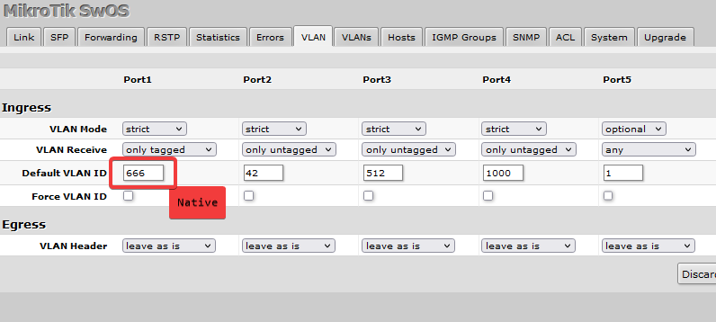

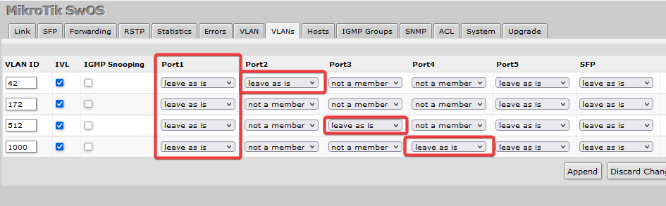

CSS106-1G-4P-1S vlans to a Unifi switch..
Unifi profile “Trunk-1” passed all vlans except 1, native vlan set to 666.
vlan172 is management, with the unifi devices, you set the profile ‘Trunk-1’ then tell the device management is 172.. Unifi switch then lives on vlan172, and passes data from vlans defined in profile ‘Trunk-1’..
Trunk-1 passes, 42, 172, 512, 1000 and a few more..
I got a little CSS106-1G-4P-1S with swOS to try and figure out vlans with swos..
with the CSS106, trying to use port1 as the trunk..
Everything seems to be working.. but I could someone who knows swOS better confirm that I am not missing anything?
Thank you in advance..
I believe that you’ve posted in the wrong part of the forum (https://forum.mikrotik.com/viewforum.php?f=17) but I can still tell you that everything is as it should be. Only one note that I found in the docs and I’ll quote:
