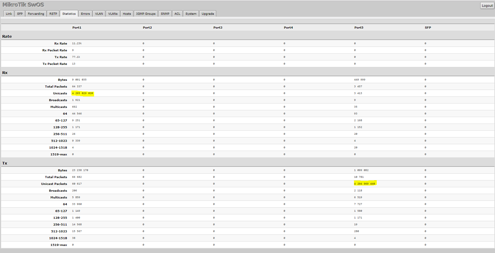

CSS106-5G-1S v2.8 bogus TX and RX unicast counter with bit 32 set.

Just noticed this playing around with my new switch. I have a Raspberry Pi 3 connected to port 5 and an Edgerouter-X connected to port 1. The counters claim that over 4 billion unicast have been received on port 1 and transmitted on port 5. It is obviously incorrect, the total packets count is correct. Interpreting as a 64bit binary, bit 32 is set.
This looks like a bug to me.

After running overnight while logged into the switch with web statistics page being displayed. The only significant traffic was the CSS106-5G-1S sending web updates.
Both of these unicast counters increased by unreasonable amounts.
Perhaps just the fact that the web page was being displayed has something to do with the counters being incorrect.

Bogus Unicast Tx and Rx counters on CSS106-5G-1S SwOS 2.8 after running overnight.PNG
