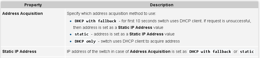

Do the CSS106 switches avoid duplicate IP address 192.168.88.1 when multiple “out of the box” switches are deployed on a network with no DHCP server?
The documentation suggests that the v2.5+ default method “DHCP with fallback” will use the configured address if no response is received from DHCP server within 10 seconds.
There is no mention made about whether an ARP request is sent to the specified address before the switch uses it.
