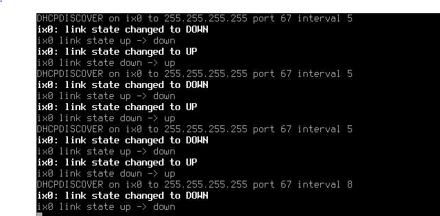

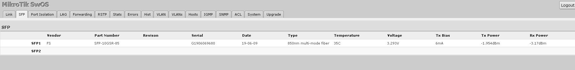

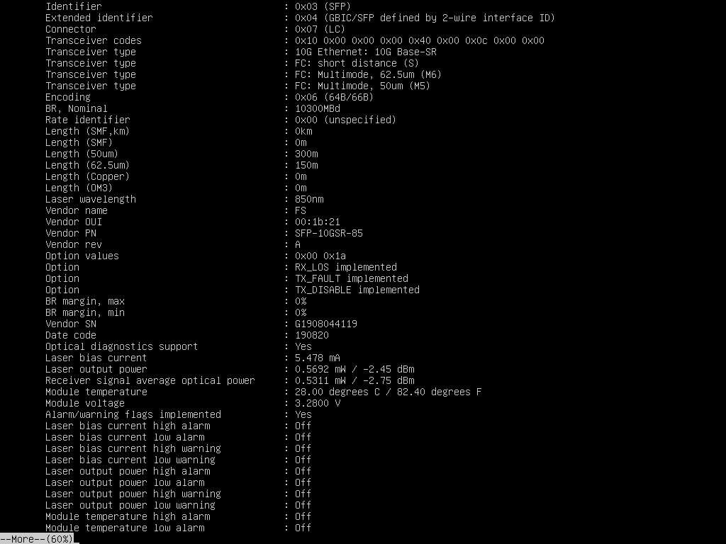

Practically I have link up for 1-2 seconds and then it goes down. Tx and Rx power values are right at both end. I see some kbytes through the link, both Tx and Rx, on the stats page.
At this stage, to not introduce variables, I am always using default configuration of the switch with all ports speaking to any port and port 1 ethernet connected to home router.
SwOS was at 2.9 level. I also tried to upgrade to 2.10 without success.

  3. I am using FiberStore module “Cisco SFP-10G-SR Compatible”. This adopt the same Finisar code of Mikrotik. Is there anybody using these modules for Mikrotik devices?
