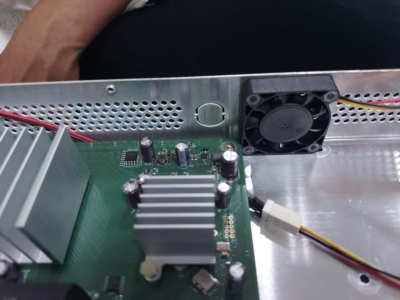

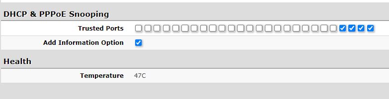

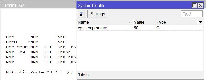

After reading this thread and found Eric Shewe (https://www.pickysysadmin.ca/2022/08/14/mikrotik-css326-fan-installation/) post, I start hunting fans for my CRS and CSS. Here my results:
CSS326 45-47°C
CRS326 49-50°C

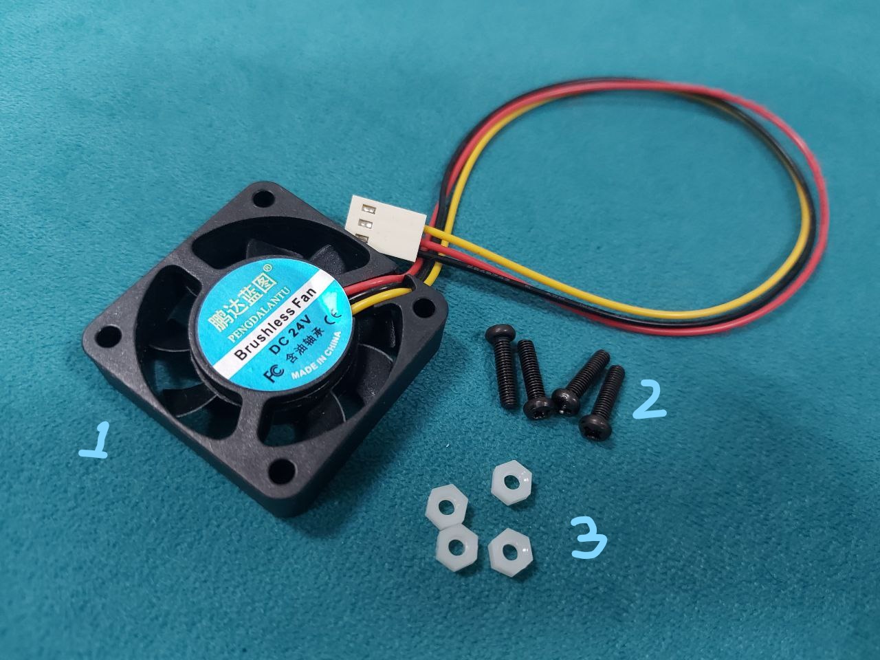

The 24V fan is rare but I choose not to use 12V version because there will be more works to do. And I’m lucky to get four 24V DC fans with 3 wires.
Here my list:
  1. 24V DC fan 40mm x 40mm x 10mm
  2. Screw Metal M3 - 12mm (my fan 10mm)
  3. Nylon M3 Pilar Spacer PCB
  4. Extra cable and cable’s fan connector
This will cost around $2 USD :slight_smile:
And the temperature drops about 20°C, from 70 to 50.
You only need 2 wires for DC: black (-) and red (+). Maybe you get different color combination, and its depend on your country.
Computer fans has 2, 3 or 4 wires (mostly 12V). The first 2 for electricity, the 3th for sensor and fans speed, the 4th for other control like LED. So, no matter how many wires its has, we only need the black one (-) and the red one (+).
Mine has 3 wires: black, red, and yellow. And I only use black and red.
