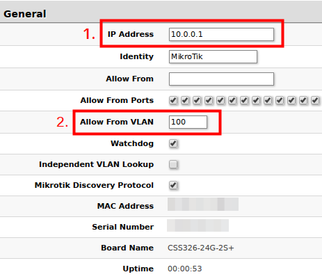

Here is configuration to have management IP 10.0.0.1/29 on VLAN100 in SwOS:
Note that VLAN100 should be configured first in SwOS to avoid losing connection to the CSS326.
