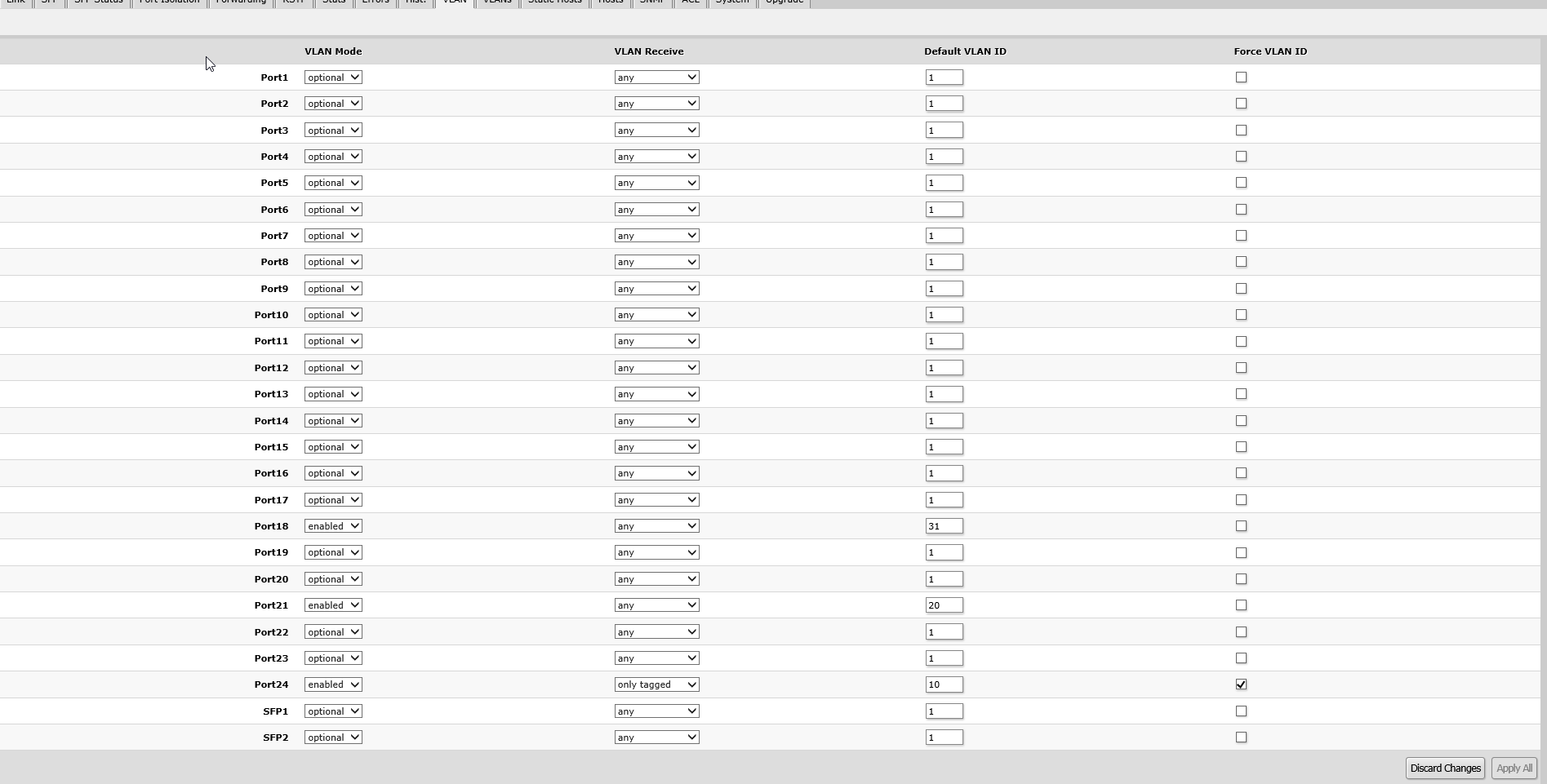

I am somewhat confused as to how to configure vlans on this switch (css326-24g-2s+rm) I just purchased. The Vlan config does not match the same as your SWOS documentation. For example, there is no ingress/egress, so where is this to be found? I simply want to know how to configure trunk ports, tagged ports and access ports.
I have attached screenshots to show how different it is from documentation and the lack of “egress” and “ingress” as stated in the docs.
The wiki does not seem to cover SwOS 2.0 for now :frowning:
I hope mikrotik is going to update it quickly because swos 2.0 is not behaving the same as pre-2.0 when considering VLANs
I would also appreciate help from the Mikrotik folks on this, even if the official documentation is not done. I am moving from a netgear gss116e switch with several vlans and a couple of trunked ports. From the earlier documents I could figure out how to match my setup, but with the new UI, it’s not clear to me at all.
