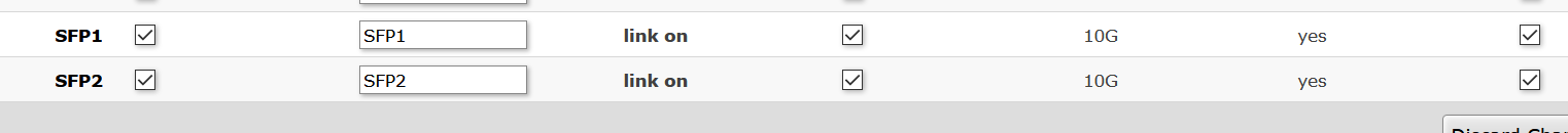

The link status drops every 2-3 seconds but I don’t get any errors so I am not sure why it can not maintain a link.
Is it normal for the interface type to be 1m copper?
Vendor Part Number Revison Serial Date Type Temperature Voltage Tx Bias Tx Power Rx Power
SFP1 MikroTik S+RJ10 2.16 AF9403A37AF3 19-05-29 1m copper 86C 3.295V
SFP2 CISCO-MOLEX 74752-9520 09 MOC161709W6 12-04-28 3m copper
SFP1 no link no
SFP2 link on 10G yes
