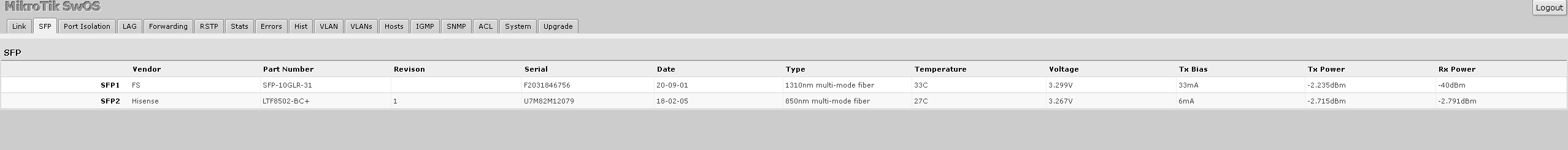

So i have a CSS326-24G-2S+ switch flashed to newest firmware that is giving me a ton of issues when i use SFP+ ports with singlemode fiber

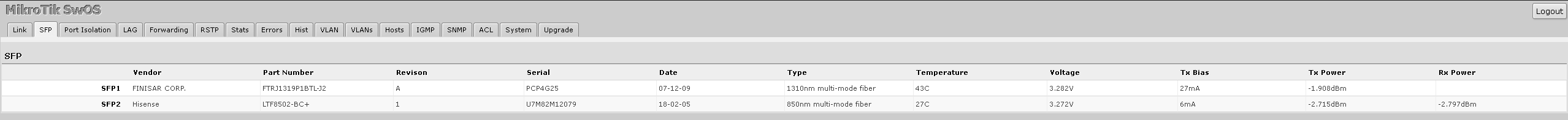

So first issue i have is that it detects any SFP i plug into it as a Multimode one, i have tried the 2 brands i have FS and Finisar

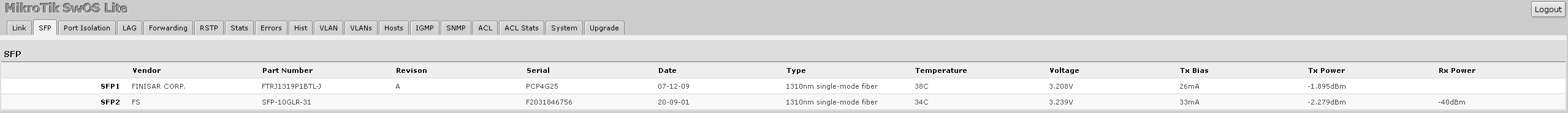

When i put them in my CSS610-8G-2S+ they get detected as Singlemode SFP, i have tried multiple sfp’s so its not a issue with the actual SFP’s as far as i can see

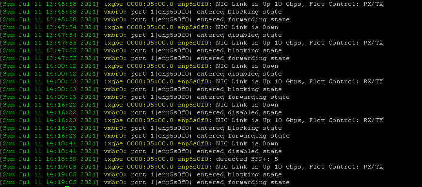

The real problem comes when i run linux\windows in any setup as vm’s or solo installs, it will have constant 1-2seconds disconnects on the CSS326-24G-2S+ switch but not on the CSS610-8G-2S+ switch, i happens with all singlemode sfp’s 1gbit and 10gbit ones, i have tried 3 different network cards a ton of different cables, it happens with all of them, i have tried 2 different pc’s on the CSS610-8G-2S+ switch it can run for a week without any disconnect or error.
Here is the error messages it spits out
But as soon as i put in a Multimode SFP it works without spitting out any errors or have any disconnects.

Also on a note, the Hisense SFP is an actual Multimode SFP, so thats showing correct.
