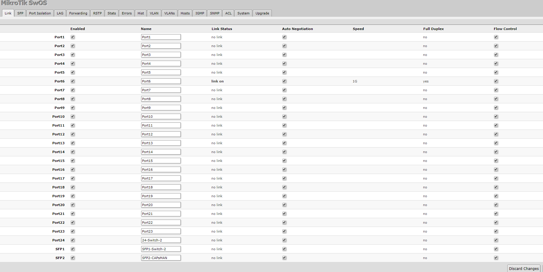

I’m deploying a new rack with two switches CSS326-24G-2S+ and a RB960PGS, the routerboard will act as CAPsMAN
Between the two CSS326 switches I use a S+DA0001 SFP+ and it works very well.

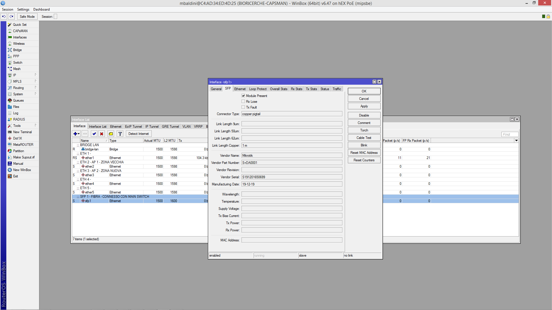

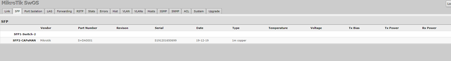

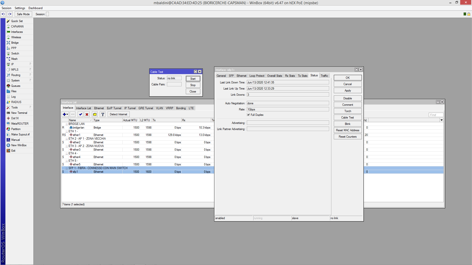

I would like to connect the RB960 via SFP, but if I connect another S+DA0001 to the RB960 I cannot get cable link.

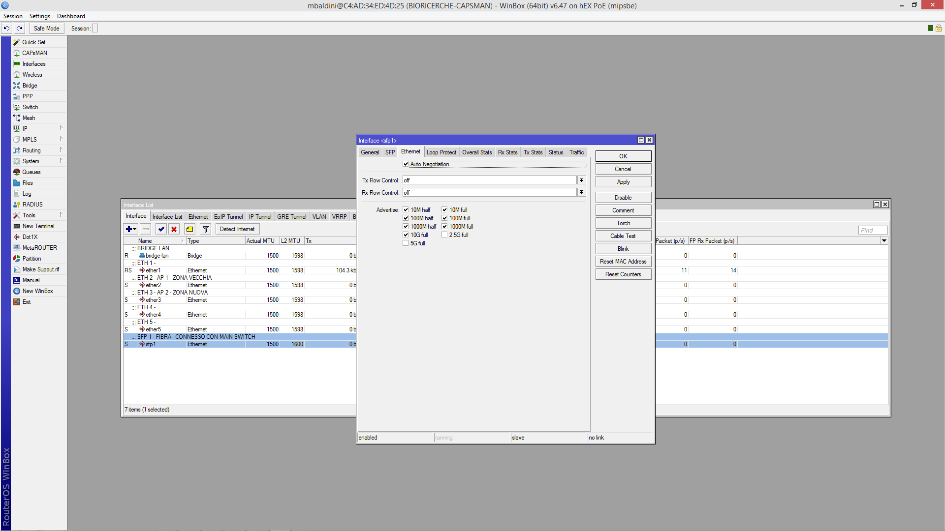

I attached some screenshots from configuration of both devices.
Can I solve this problem?
Both cables (S+DA0001) are OK, right?

I just finished putting cables in a rack with two CRS326 connected with a S+DA0001 and it’s working, I connected a CRS112 with a RB760 with another S+DA0001 and it’s working.
The problem arise only when I connect CSS326 (with SwitchOS not RouterOS) with RB960.
Could it be a compatibility problem in CSS326 SwitchOS software?
Turn off auto-negotiation and force 1G on the interfaces in both ends of the cable.
I haven’t seen the option to turn off auto negotiation in SwitchOs, today I’ll go to customer and check if there is the option. Thanks
