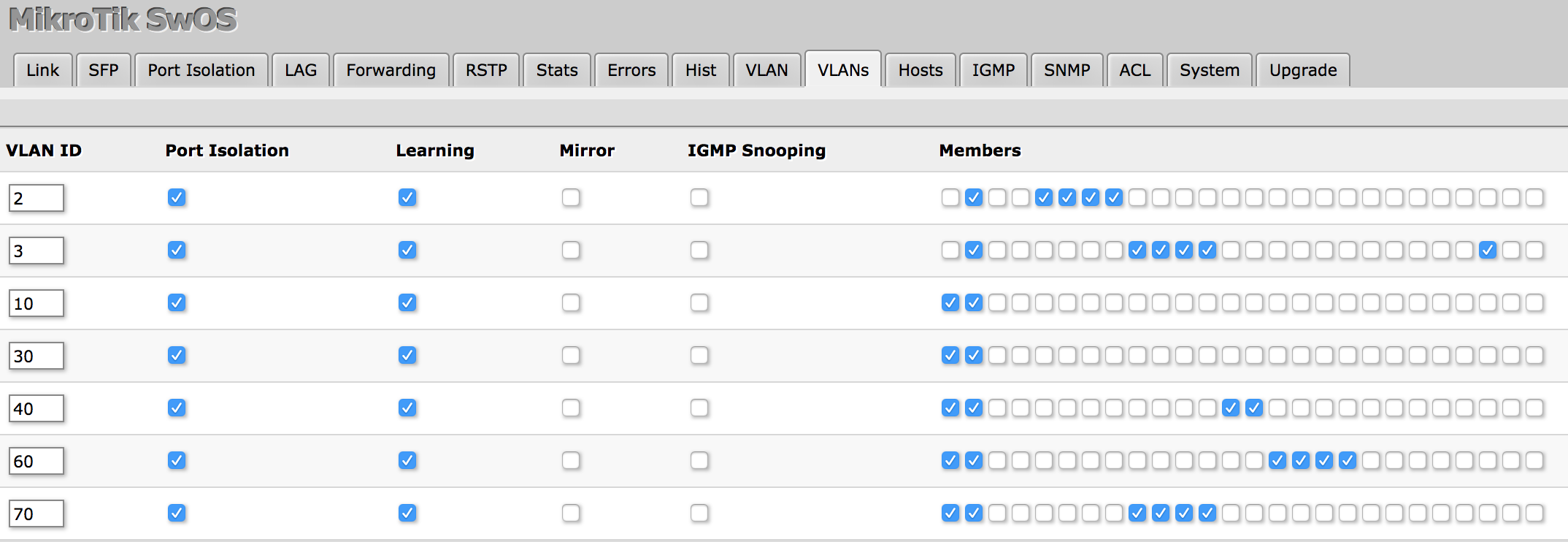

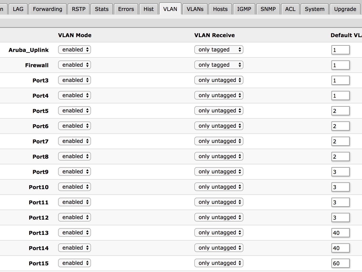

I have a very simple setup. I have a CSS326-24G-2S+ runn SwOS 2.7. I am trying to get vlan trunk to work properly. My setup is:
SwOS Trunk on Port 1 Connected to Access Point —> SwOS Trunk Port 2 connected to Firewall. I then have several access ports that also connect to the same firewall which are working fine. The issue is that no matter what I have tried have not been able to get the Firewall and Access Point to communicate over trunk port. At present I have vlan 10/30/40/60 which should run over the trunk port. I have added the firewall and access point to all of the vlans and have left port 1 + 2 with native vlan of 1. Have read over several documents and believe my configuration is correct but doesn’t work. My hosts communicating to the firewall on local vlans (also tagged up to firewall) are fine. I’ve run captures on firewall and see no traffic on that port at all.
