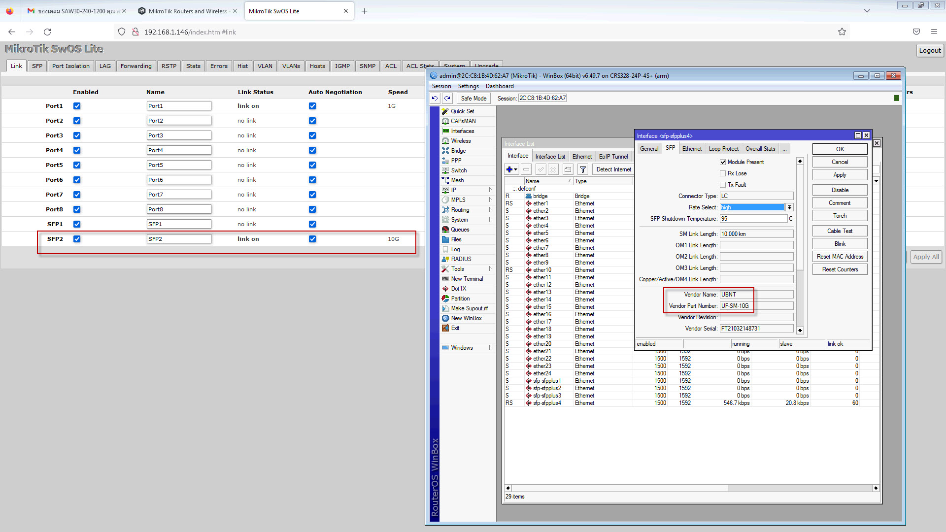

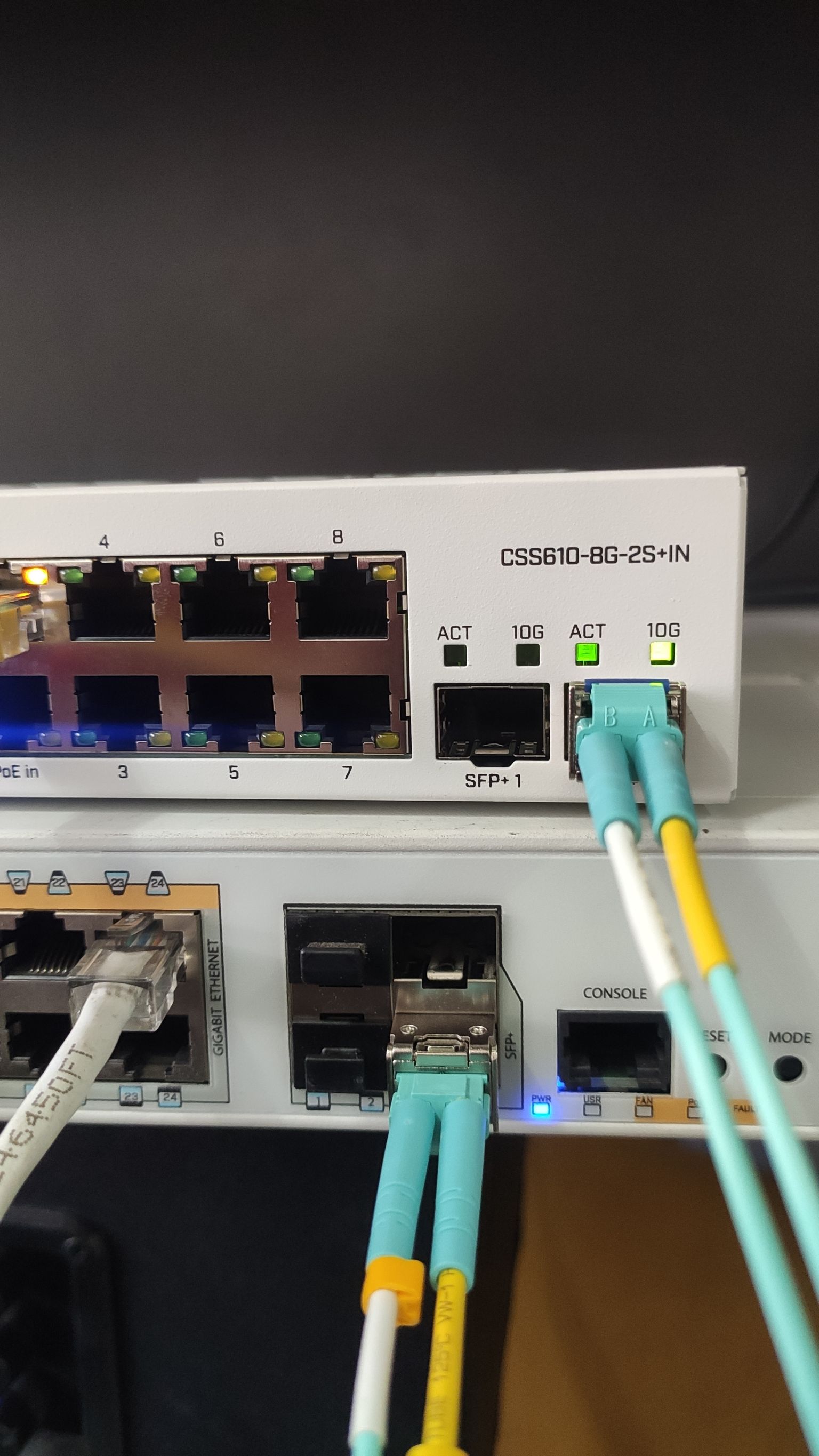

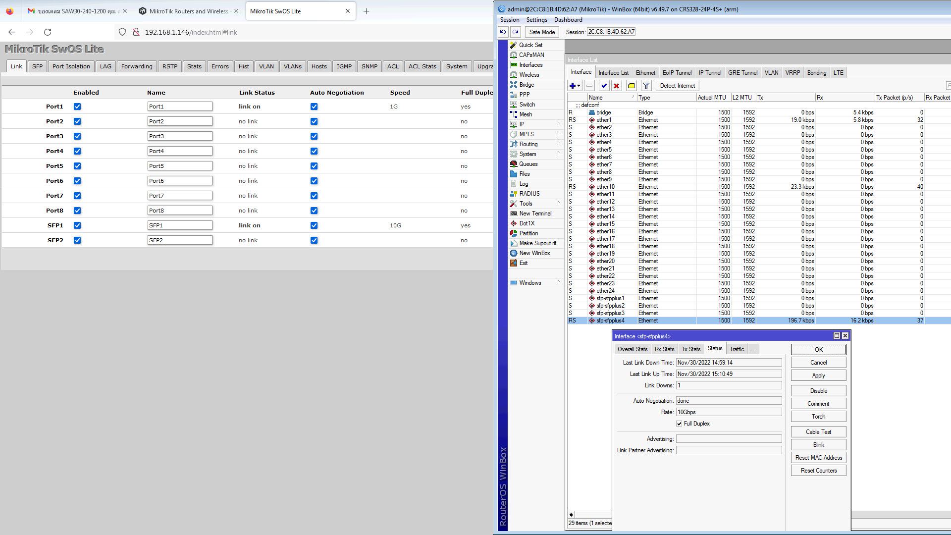

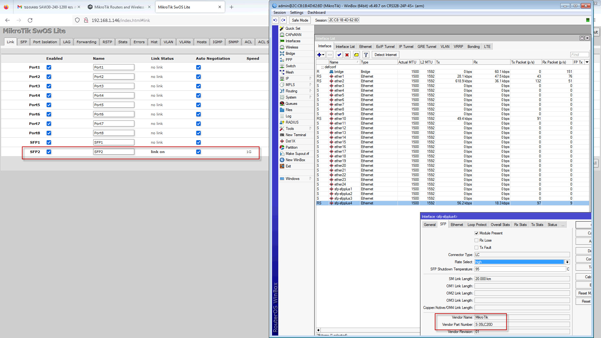

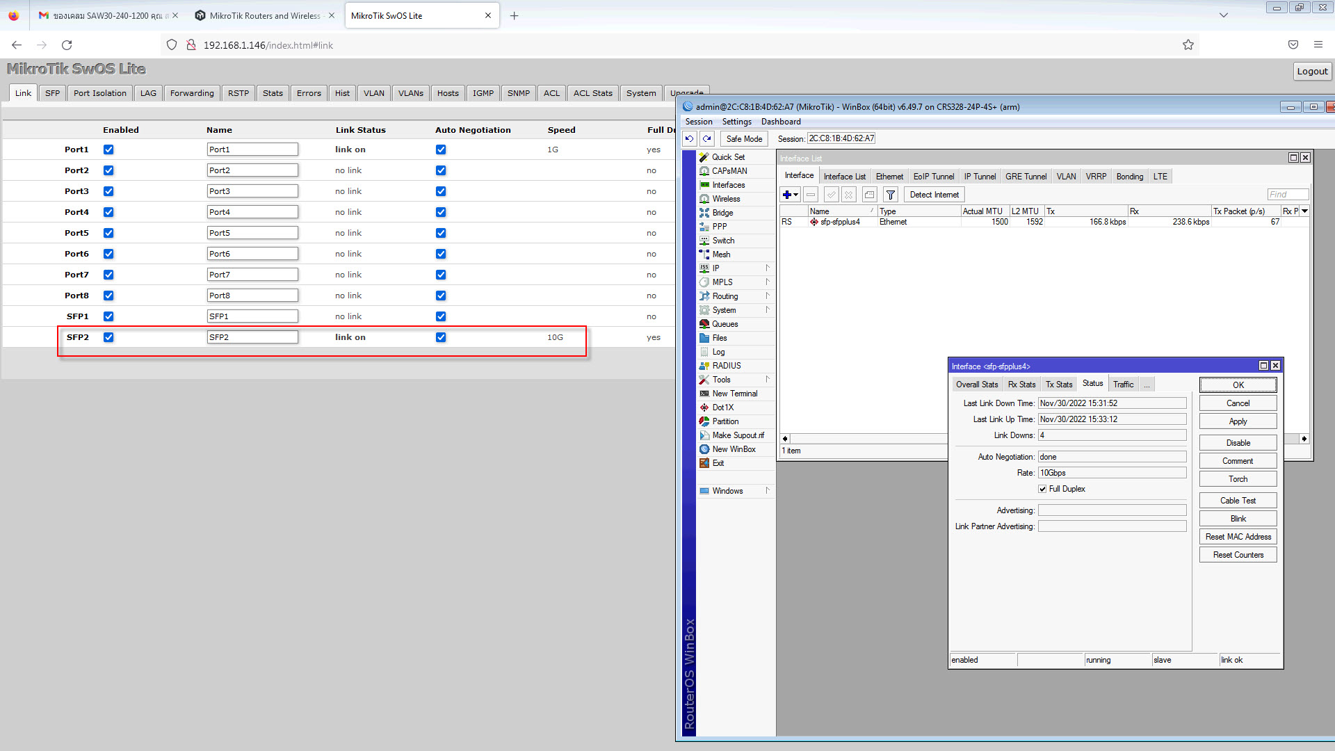

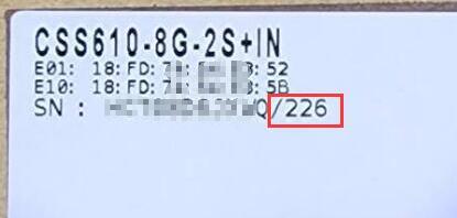

CRS328-24P-4S+RM ROS v6.49.7
CSS610-8G-2S+IN SWOS 2.13 and 2.14 #lot number 226
1.XS+DA0001 can use
2.S+85DLC03D =not link
3.UF-MM-10G =not link
4.S-3553LC20D=not link
specifically SFP+1 not available
And I have lot 226 92 pcs. tested as same
1.XS+DA0001 can use

Mine is also produced in this batch of /226. (Other batch numbers are normal)

Batch ending /250

batch /226

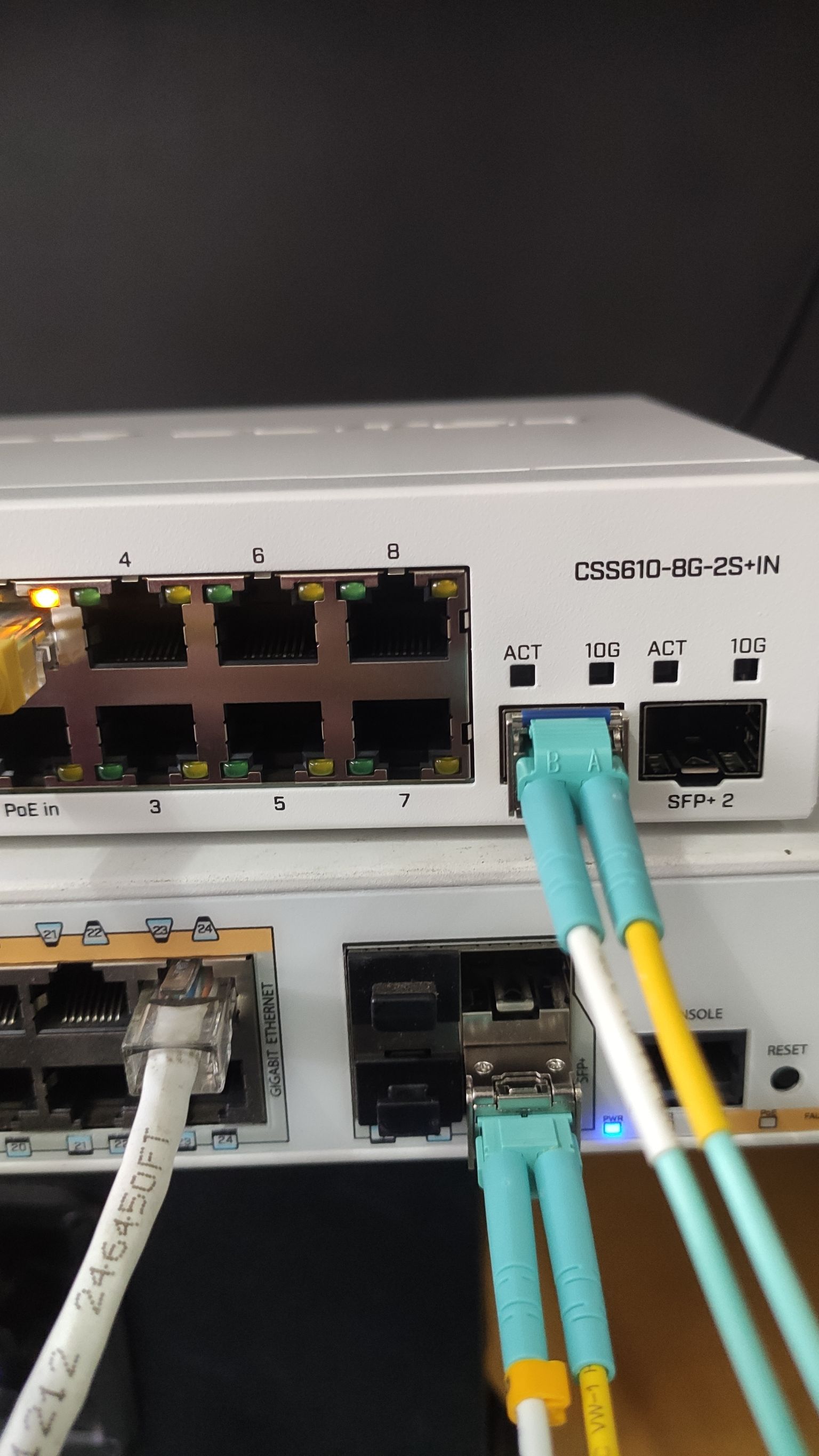

I Have two /226 batch switches and mine fail but are the opposite. Only SFP1 will work. Number 2 will not work.
I have tried about 10 different SFP+ brands and types (I work for telco so all pluggable modules of different brands and types are not an issue for me to access) but I can not get SFP2 to come up or even recognize when a sfp/sfp+ is inserted.
