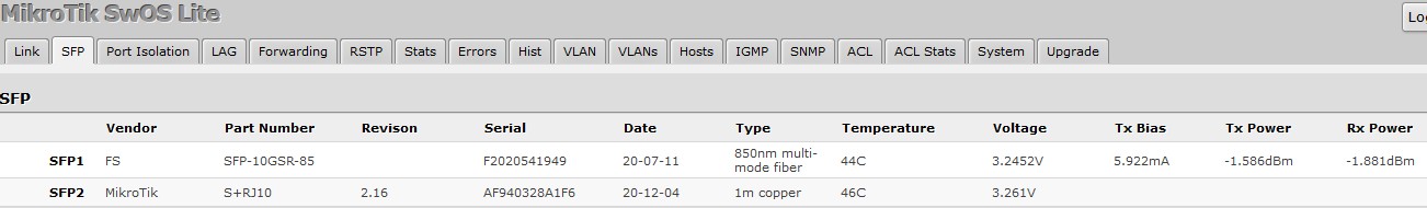

Hi all,
I’m experiencing an issue where my CSS610-8G-2S+IN’s SFP+ RJ45 10G is dropping link when both cages are occupied
Has anyone encountered this behavior?
When I use the S+RJ10 on its own in the device it works fine. but I also have a CCR1009 with SFP+ linked at 10g using fiber.
as soon as both SFP+ ports are active and have link the S+RJ10 keeps flapping (visibly on the device i see both lights go out)
if i only use 1 SFP+ cage at 10g (either with the S+RJ10 or the fiber 10g sfp+) all works fine.
This is on: 2.13rc12 due to being unable to access management over the SFP+ ports earlier.
I hope someone is willing to shine a light on this/point me into a direction to start looking at.

About a year ago I was using some Mikrotik SFP+ 10Gb RJ45 modules and they got hot as hell. Mikrotik have a warning about this on the wiki https://wiki.mikrotik.com/wiki/S%2BRJ10_general_guidance . Might this be contributing to your problem?
Oh I know they get quite toasty, even on their own in there.
74 C at idle with room temp at 20 C.. its quite excessive, but somehow still operates just fine..
As for the 2x SFP+ cage issue. this has been resolved (just now) with the unannounced/ninja upgrade that was suddenly available today in the webfig!

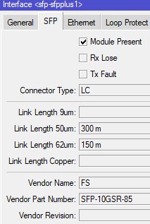

Off topic to your post, but can you tell me how your FS transceivers are coded? I just got four of those FS-10GSR-85 modules today for my CSS610, and they don’t light up in the SFP cages. SFP tab doesn’t show anything. Mine are Cisco coded.
sorry for the late reply! I have orderred these from FS:
Also CISCO coded AFAIK.

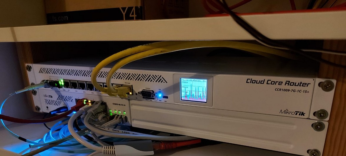

I did no further configuration other then connecting them to eachother with a OM4 LC-LC cable. other side is a CCR1009-7G-1C-1S+
