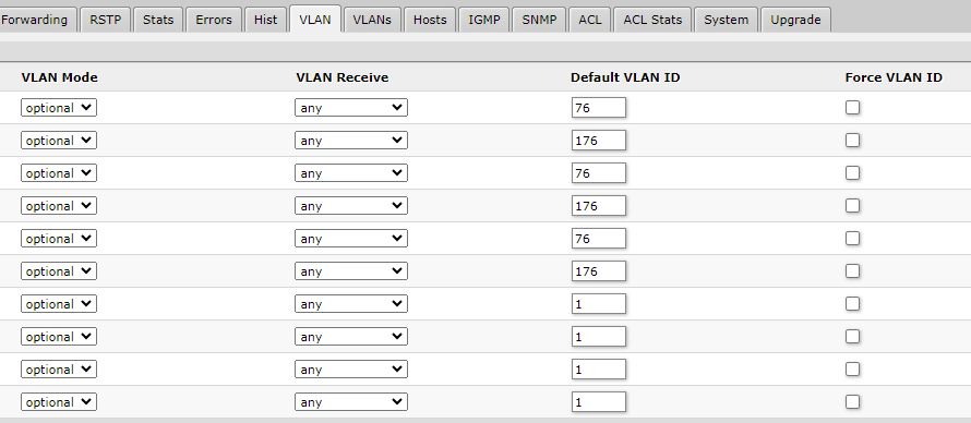

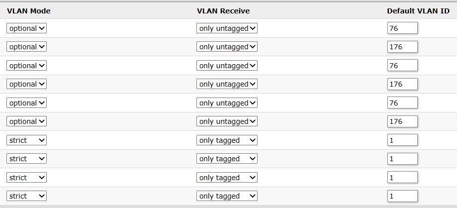

I have the following VLAN-Konfiguration on both switches:
  • VLAN-Modes:
  • VLAN-Ports:

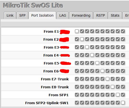

    This is my Port Isolation Configuraiton:
    And there are no ACLs.

VLAN-Config is ident for Eth7,Eth8,SFP1 and SFP2 on both Switches.

I played around a little bit and the following solution worked for me (but I do not really understand it, because the VLANs Tab is empty).
SW1:
This is the definition in VLAN-Tab:
  • Trunk-Ports are Port 7+8 and SPF 1+2, they are in VLAN 1.
  • Access-Ports are Ports 1-6, where I define the VLAN.

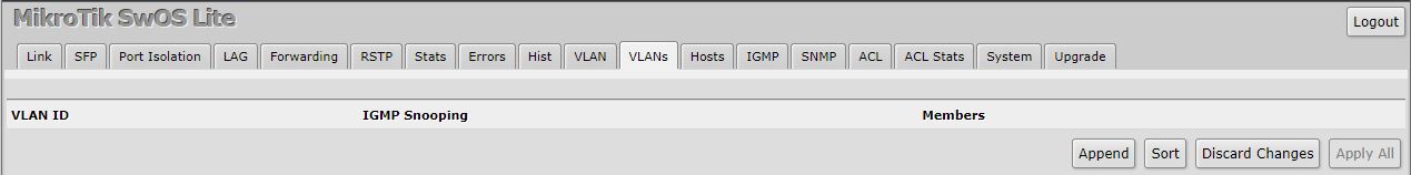

    The VLANs-Tab is empty.

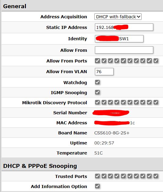

    System-Tab
    In the General Section I added the Allow-VLAN.

    VLAN-Tab:
  • Trunk-Ports SPF 1+2, they are in VLAN 1.
  • Access-Ports are Ports 1-8, where I define the VLAN.
System-Tab
